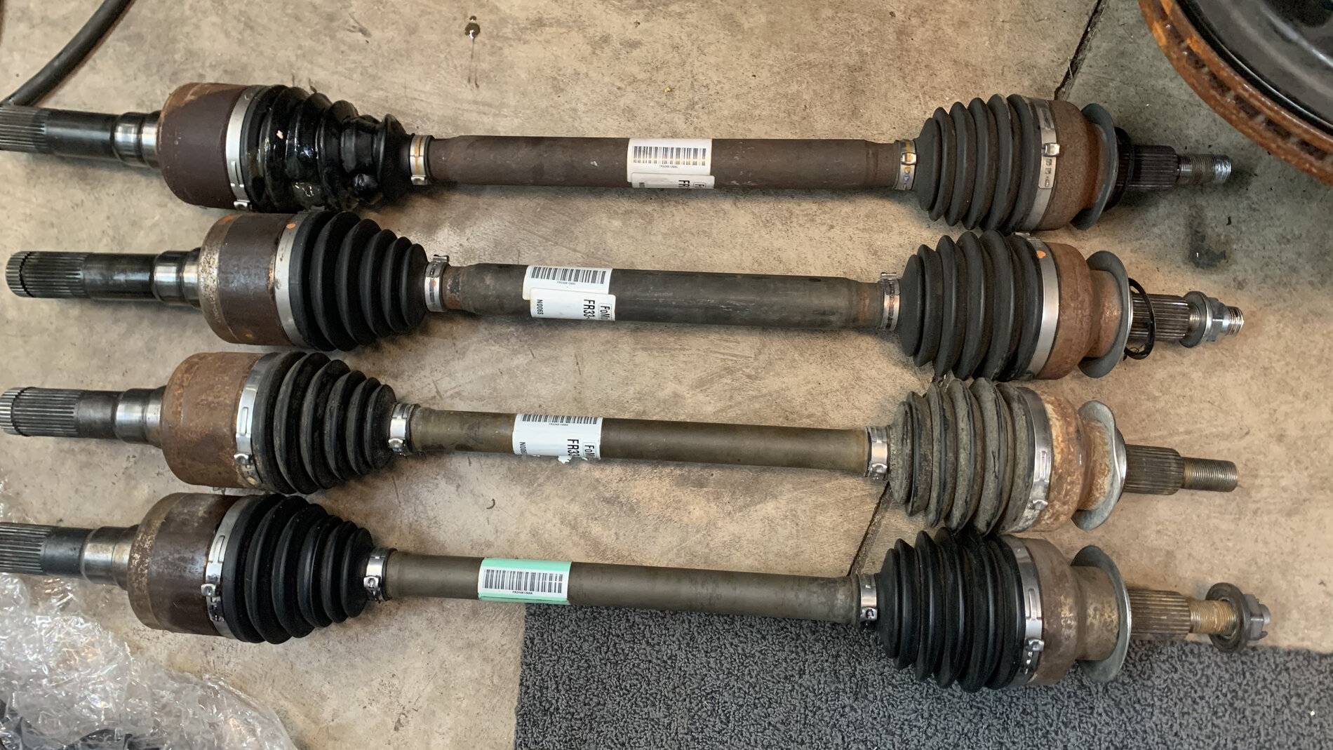

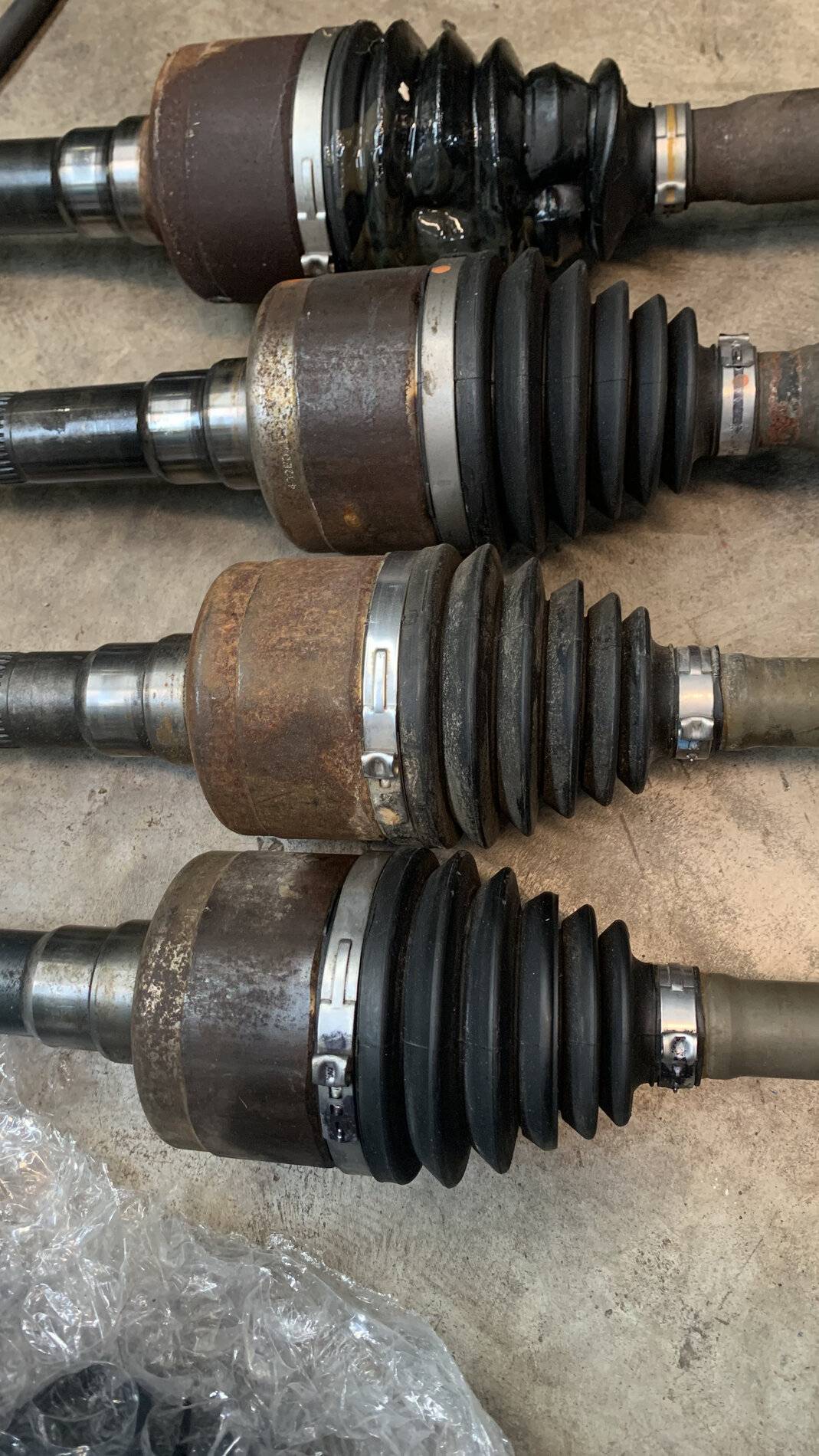

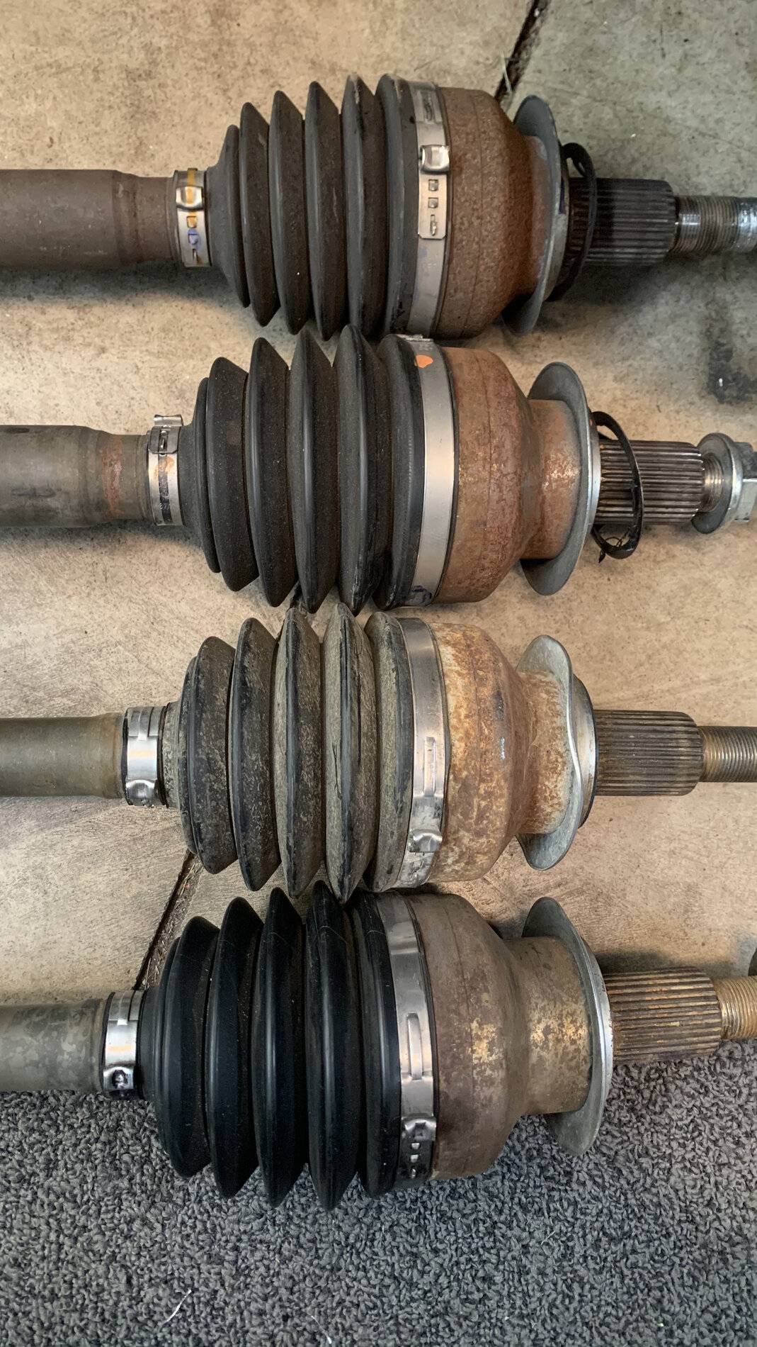

so the top (#1) is a drivers side Ecoboost shaft
#2 is suppose to be a dr side from a GT

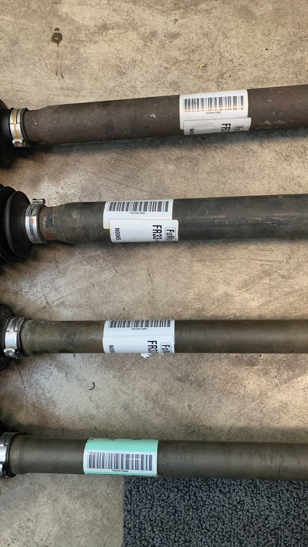

#3 is what I have questions on. part number on sticker is FR334K138BD was told its the dr side from a '17 GT350R
#4 is suppose to be a pass side GT350R

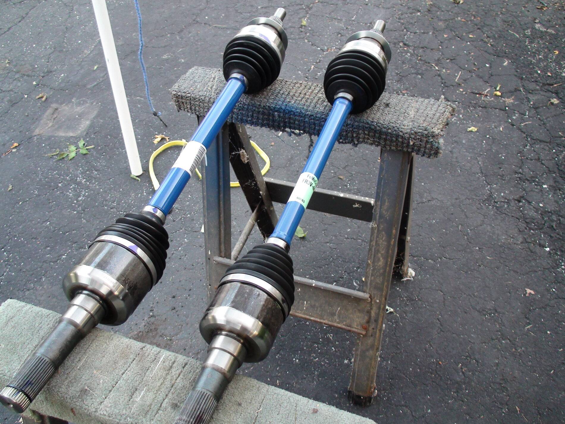

Your #3 and 4 both look like GT 350 passenger sides. The CV on the drivers side should be a lot bigger and heavier like mine on the left. Painted mine blue.

are yours the ford performance gt350 pair or are they actual gt350 production car takeouts? if they are take outs do you have the part number on the stickers, both?
so much for buying stuff on eBay from 'respected sellers' was sent 2 #4's then they sent me #3 so it appears I have 3 of the same shafts.

Mine are from the Ford Performance GT350 kit. Only paid about $325 for both sides a few years ago.

The kit is still listed for only $340 on the Levittown Ford site. I wouldn't bother just buying one side. Part # M-4130-M8S

Ford parts guys should be able to look up the label part # to confirm for sure what they are and what they came out of instead of trying to guess by axle length and boots...
