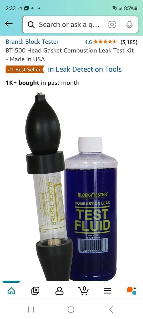

Are you sure it's boiling and not just bubbling from combustion/exhaust gas pressure? A head gasket can fail in several ways. Mine had a micro leak into the combination chamber. I never saw any coolant anywhere. Just had the #3 misfire and a borescope on a cold engine would see tiny fleks of coolant on the piston edge. Never any coolant in the oil above a microscopic level. Blackstone found it, but it wasn't enough to visually change the oil.
If you're doing the troubleshooting yourself, you might consider picking up one of the testers that detect combustion gas in the coolant. And/or borescope the offending cylinder.
