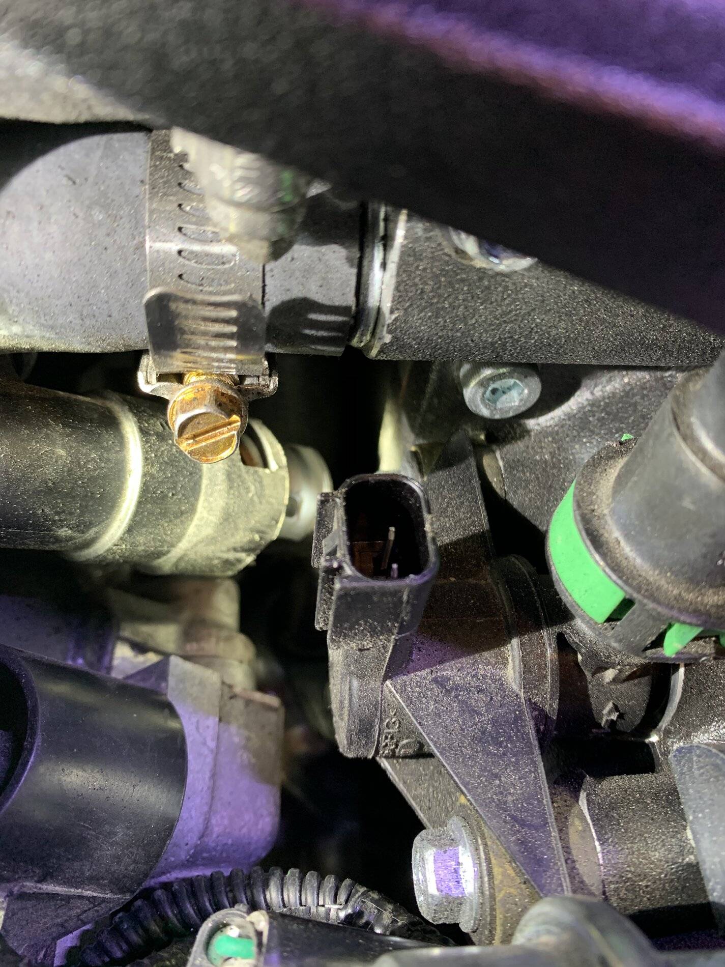

So I took off the covers from the blower (side covers that say “supercharged”” and moved the hoses around to see better. Well, moving the left side I hear a hiss sound! I’m pretty sure that’s it! It’s the hose that connect to the tube mounted on the head.
At least I can try that before pulling it apart.
thanks K4fxd. Something like that would have escaped me. I would have just five in lol.
I’m praying this is it.

No. Don’t have either. I read about them but I think it would be too difficult to do with the motor in the car. It appears that the hose wasn’t on the white coupler as tight as it should have been. Somehow came loose. That’s my guess right now. I’ve put it back on again. I’m hopeful. Don’t want to start the car tonight and tick off the neighbours lol so I’ll try it tomorrow and see what happens. Maybe I can get a pressure tester if it’s still leaking and see if I can narrow it down before yanking the blower if I have to.
My fear was / is a cracked block in the valley but seeing and hearing the hose connection has me thinking that’s it.
Do the white plastic couplers that the hose clips into break or weaken over time? There’s about 5000 miles since the install and this is the first sign of anything like this. Maybe disconnected somehow or loosened over the winter.
