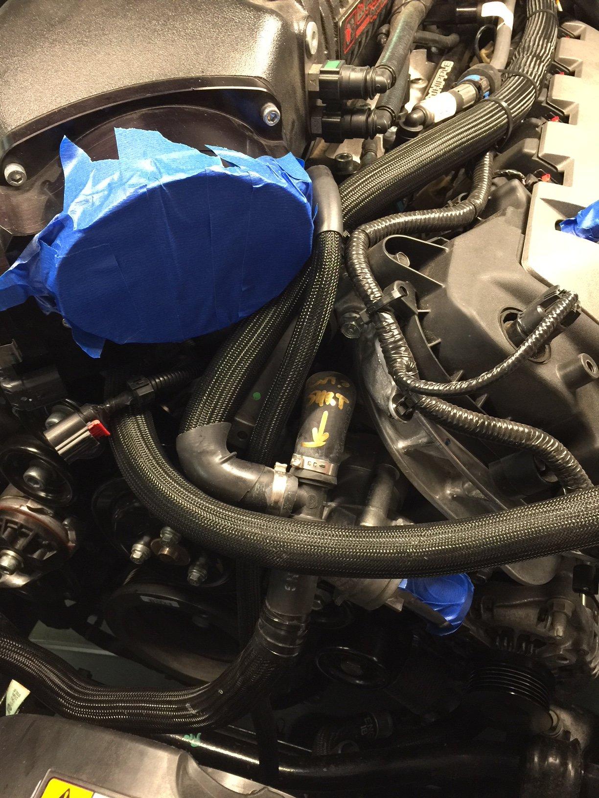

You're on the right path. Pressure tester to find the leak. I bought one when I was chasing a coolant leak. Found a pinhole in the line going to the reservoir. Only happened at high RPM and heat, so I could never find it when it was just sitting idling.

Haven't gotten the pressure tester yet, but I took a closer look at it yesterday with a brighter light. I can see residue around the black coolant tube going from the water pump/block to the hose pictured in post #4.
Ordered it from Ford, should be here tomorrow. Only $26. From there I'll look deeper and pressure test to see if anything else is leaking.

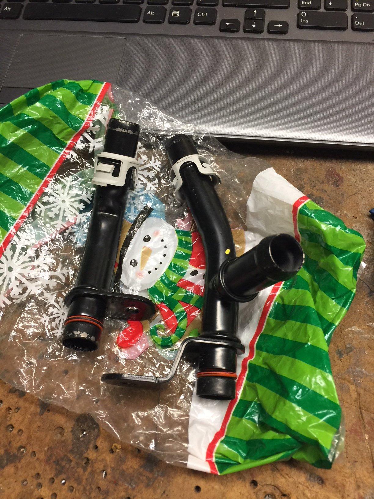

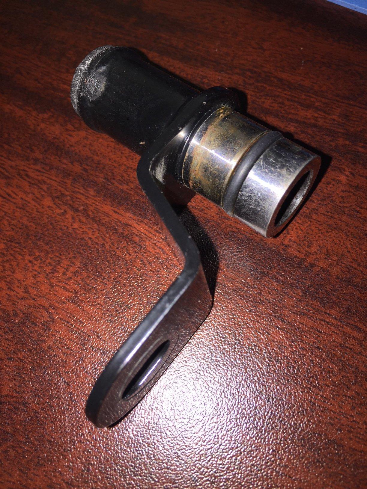

[MENTION=19978]sigintel[/MENTION] you were on the money. Replaced my coolant pipe/fitting the other day and the leak is gone. What a relief.
You can see in my valley all the burnt coolant :(
