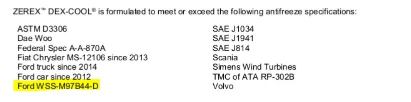

Getting ready to do an intake manifold install. Are you positive that the Zerex Dexcool is different than the Motorcraft Orange? I've searched threads here - can't find a definitive answer. Reason I ask? Zerex lists the following on the DexCool :

Motorcraft premix stuff is $12/gal. Just buy the Motorcraft and don't worry about mixing brands.
I'm not worried. I'm not mixing. I'm just pointing out that Motorcraft Orange is Dex Cool standard per Zerex.
