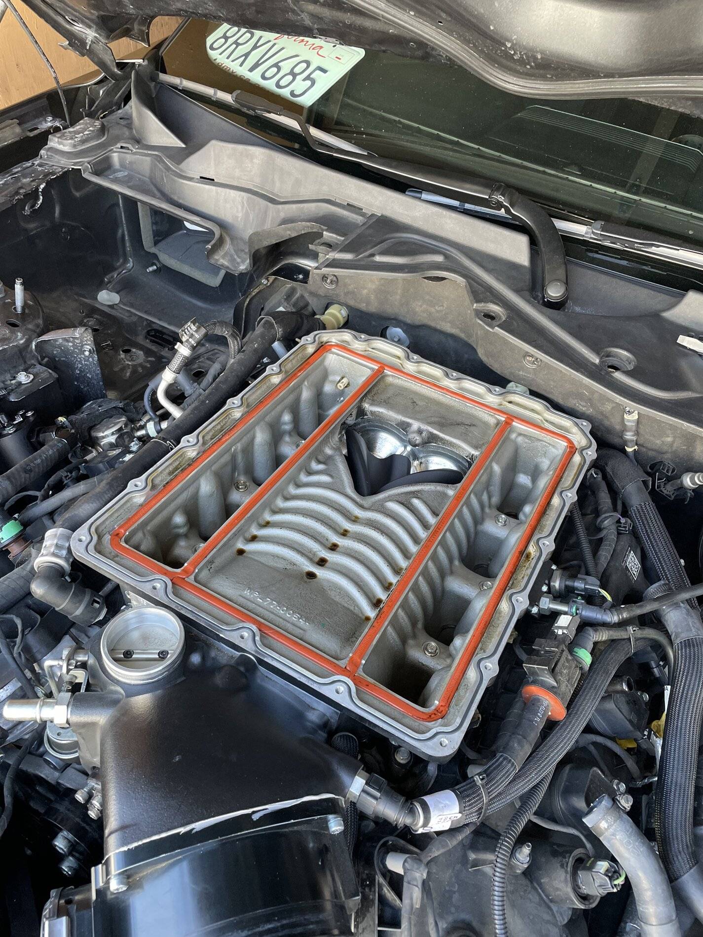

Just got the lid off, cross over oring is the big circle in the front of lid or is it somewhere else. Also does this look normal? The oil all over? Is that blow by? I’m assuming?

That’s the supercharger, the lid is the part you just removed.
the lid has the crossovers in it.
The crossovers connect the lid and the intercooler cores.
you need to look in the lid for signs of leakage

I don’t see any signs of coolant on the core side which is above the orange gasket.
look at the area that is outside that gasket and above the throttle body
