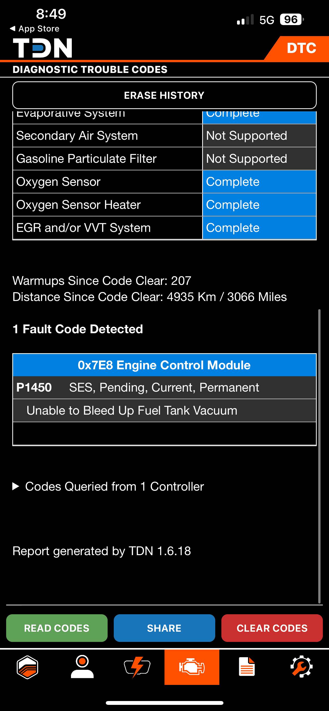

Thread revival.
Did you guys get it worked out? I have a similar permanent code causing a smog failure. I changed the purge control valve a while back and cleared the code but apparently it’s still there.
any insight would be greatly appreciated.

Do you have all the vacuum lines connected correctly?
