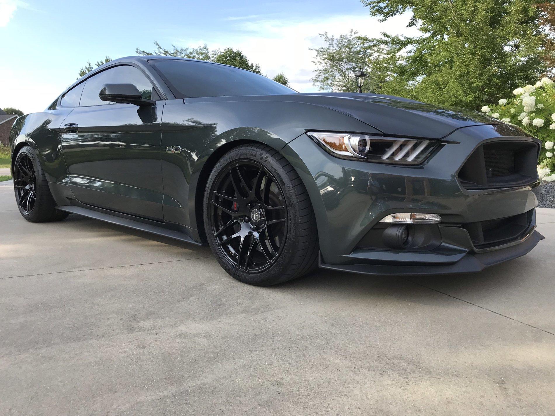

Have you considered coilovers? I’m not exactly sure how much drop I’m running but the ARH headers have never drug. I’ve got a full ARH system and it’s actually lower back by the diff. The coilovers would allow you some safety margin for adjustment

Probably an 1 to 1 1/4 drop in the front. Pic for reference

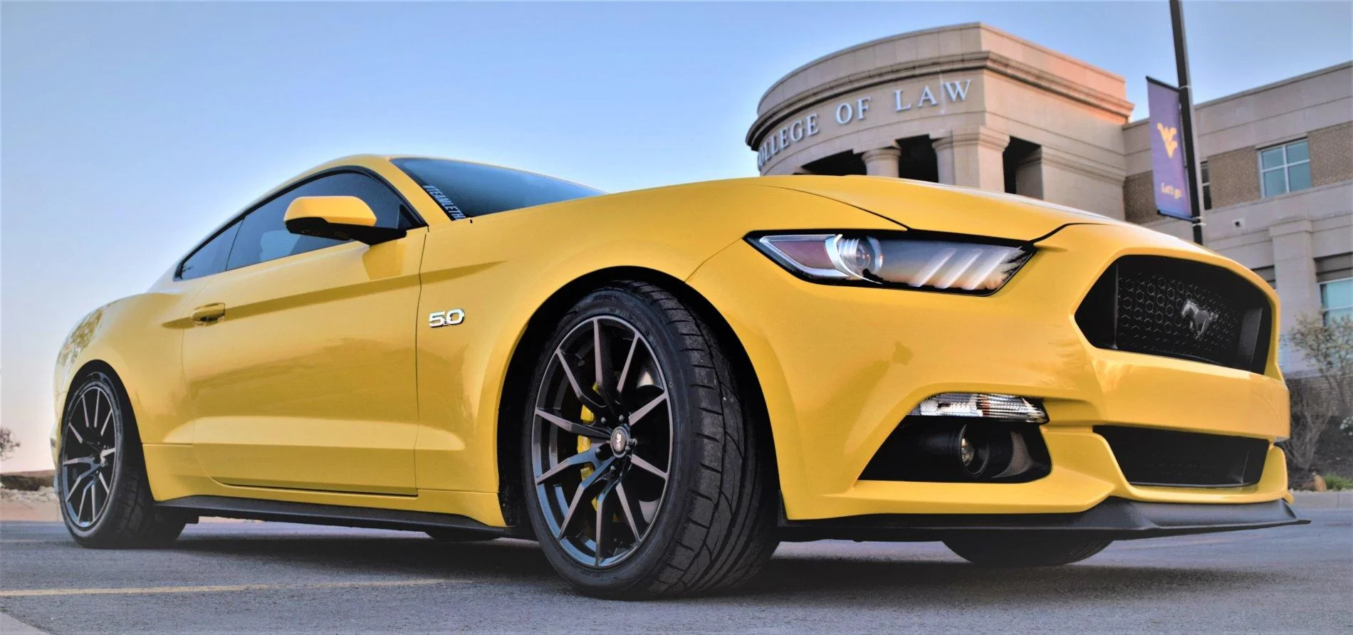

BMR SP080 springs. I never drag the headers, have rubbed the catback on high speed bumps/sharp angled roads before.
