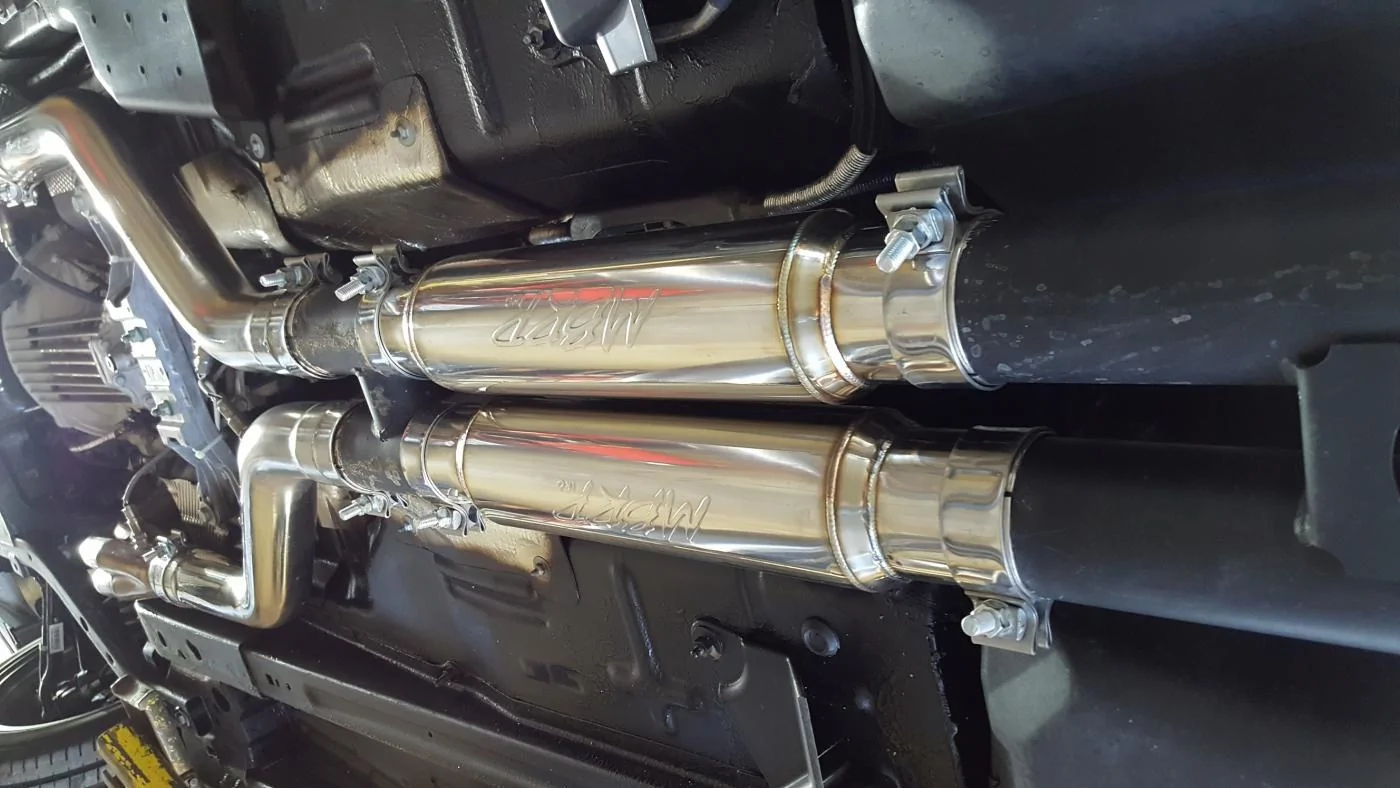

i installed these mbrp resonators right after the h-pipe

I told my wife that the OPGs were needed and that car is going into the shop. She approved this. What she did not approve and had no idea that I did headers behind her back until couple days ago I made the mistake of doing a cold start in the garage with both doors open and she looked at me and said "Do you think I am stupid?" Now I am in trouble and looking to tone this exhaust down. So aftermarket cats never last so looking for resonators. What part of cat back are you guys welding the resonators into? And any tips on what resonators to use? I did do a search on this topic but seemed to end up talking about H-pipe and X-Pipe. I have the H-Pipe.

Which resonators are those mbrp and how much did it change the sound?
MBRP R1013 3" Inlet/Outlet16" Body 20" Overall Length T304 Stainless Steel Resonator $80 on Amazon.
For me after I added the res it definately took the harshness out of of the sound level it won't make it quiet but it does tone it down.

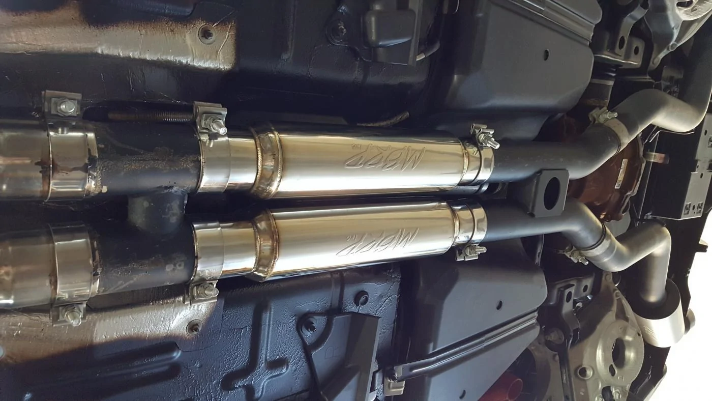

Here are where my Vibrant resonators are located.
They work great and eliminated all the rasp. I need to put them back in and high-temp coat my exhaust. Here's a video of how mine sounds with the part #.

I had some dynomax bullets installed where the catback starts angling toward the rear wheels. Definately help with rasp and toned down the volume some
