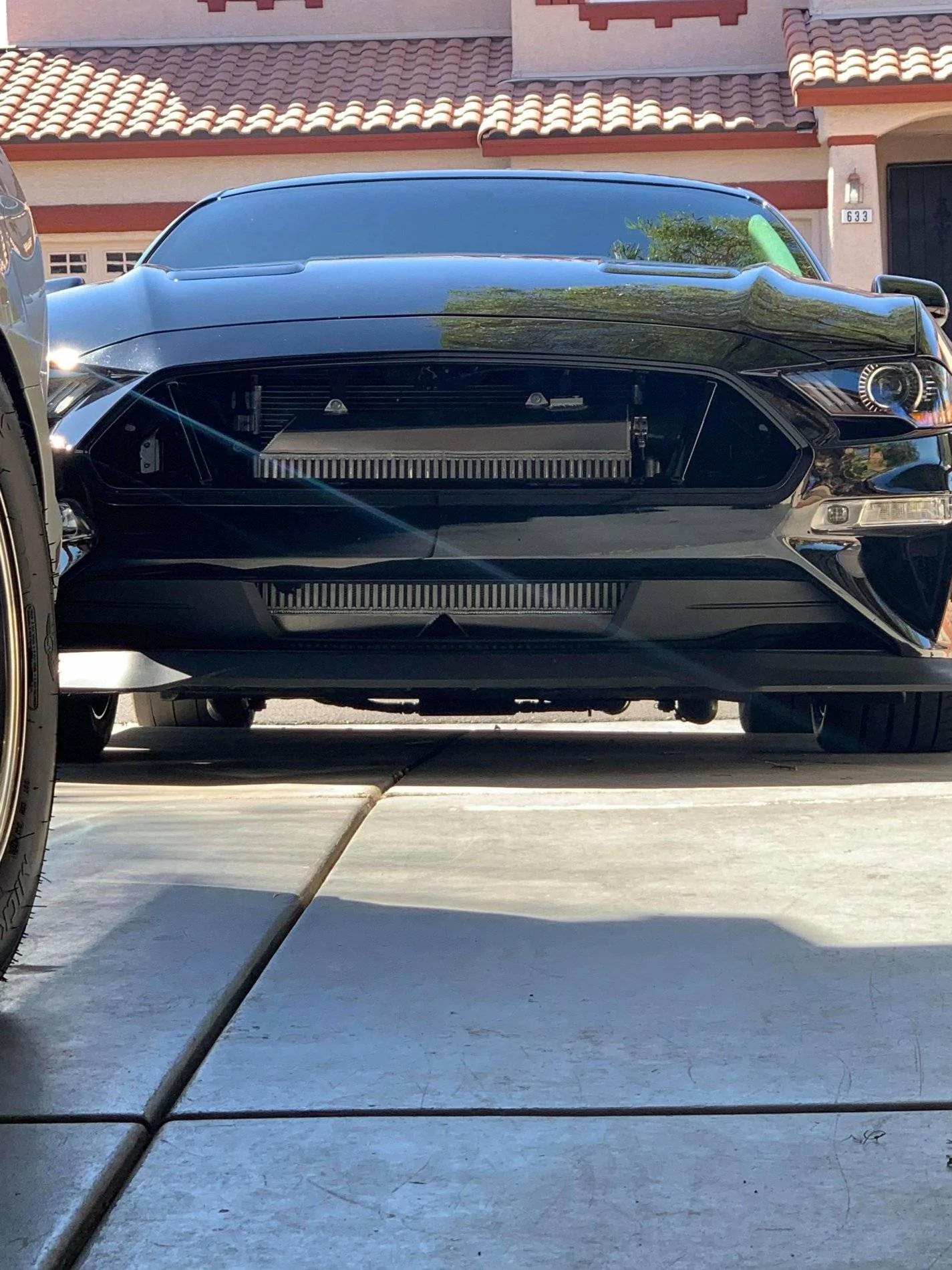

Wow, that really puts into perspective! I can see how a skid plate would be much appreciated there. Those hoses look so exposed just sitting there in the middle with nothing to protect them!

Really sucks also that tank is right in front of the oil plug, changing the oil is no fun it splashes on the tank and sprays everywhere lol. Ground clearance is effected as seen from the picture just keep that in mind.
