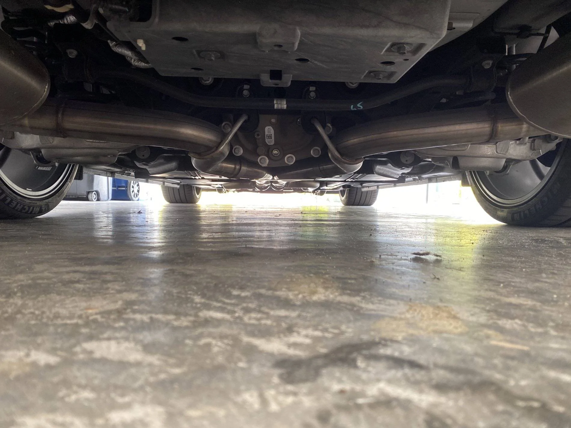

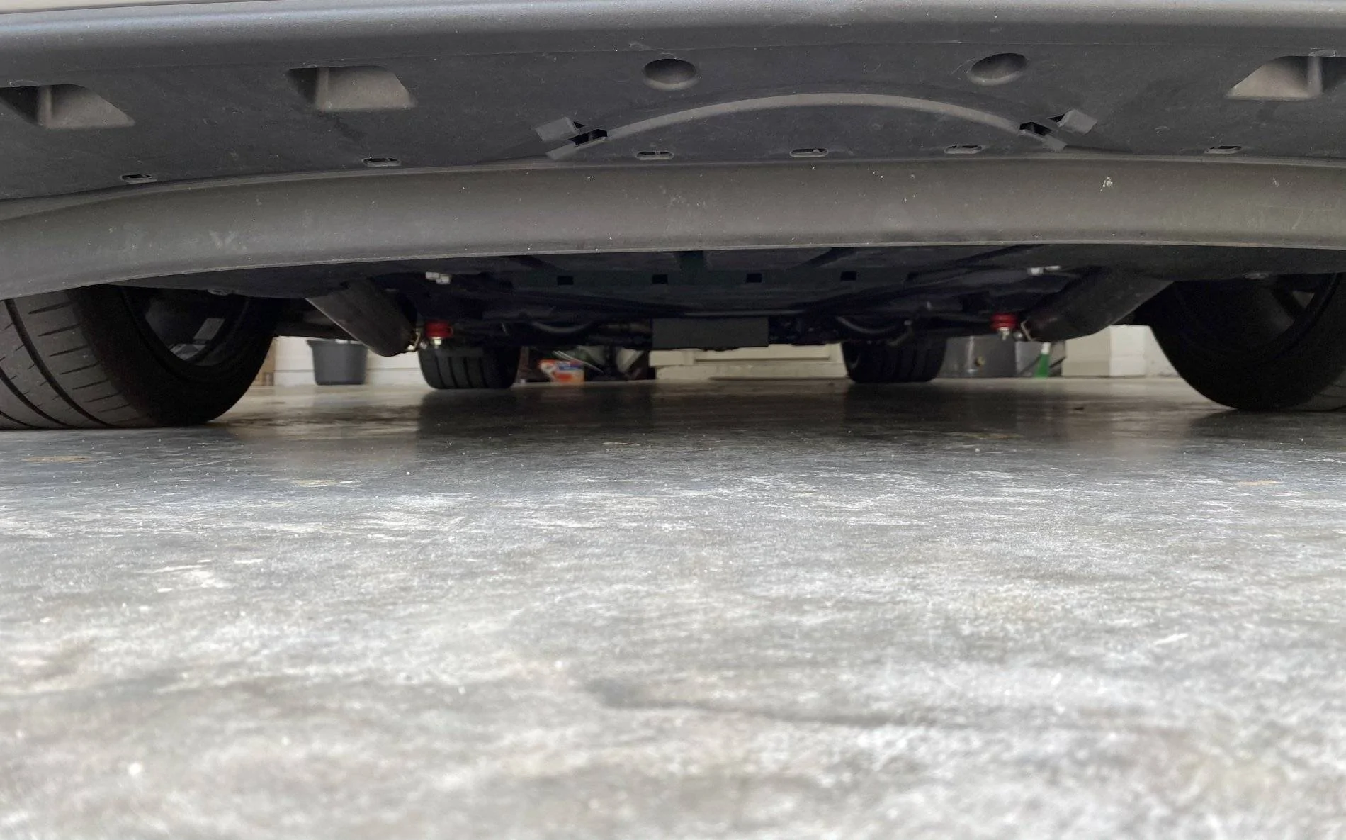

Here's the kit on a 2015 GT, stock ride height. I have never personally scraped, but I can't really recommend this kit for lowered cars. Or if it is lowered, just be careful.

Here's the kit on a 2015 GT, stock ride height. I have never personally scraped, but I personally don't recommend this kit for lowered cars.
Hello.
We feel it is important to let readers and forum members know that our R and D car for development of this kit was a lowered car (full Steeda setup) and we took the height into consideration. We have never lost any parts or had any negative results from our kit mounting. We constantly monitor all components, and have had amazing success with this system. If a lowered car was in the market for our kit please do not be deterred. You will not be disappointed!
