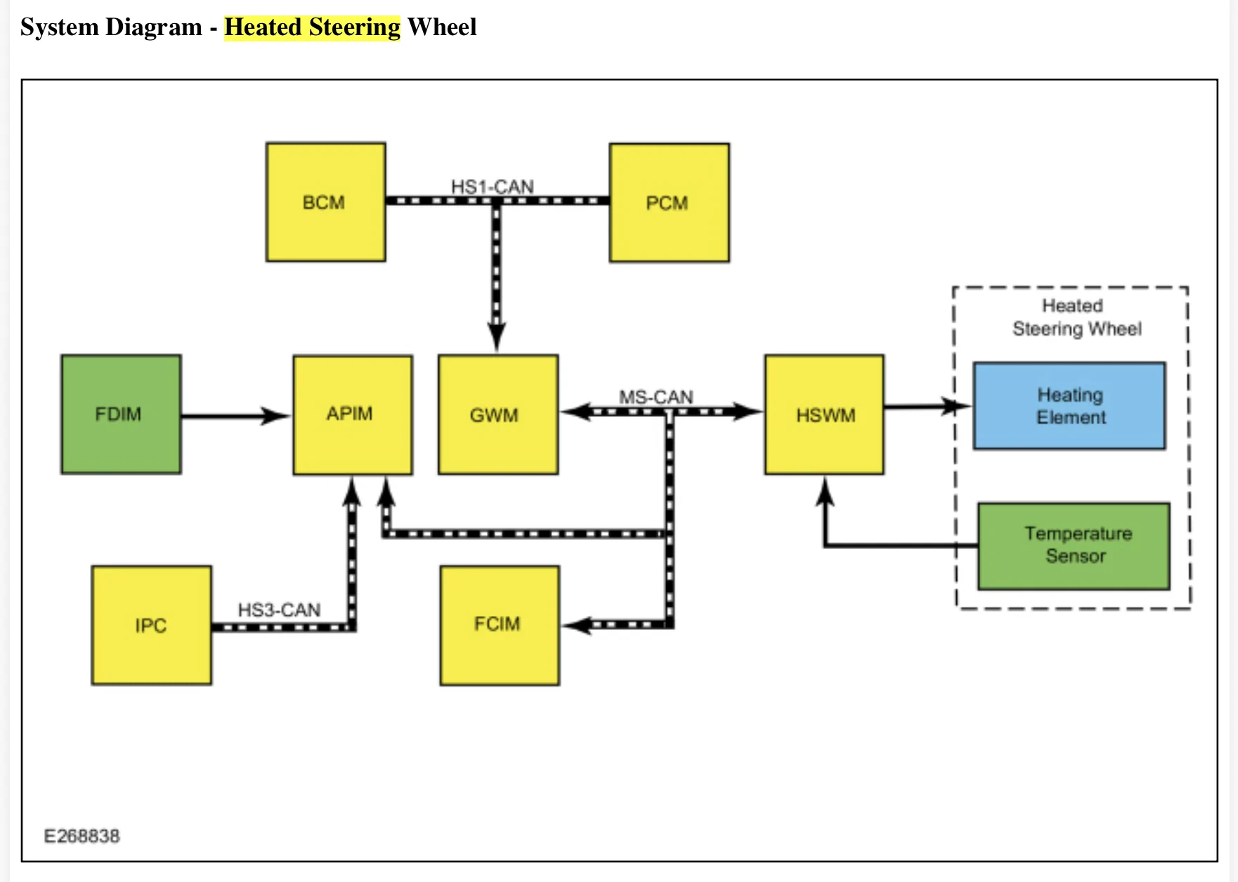

This is not normal. It should become warm (though not hot) very quickly, and then stay warm for as long as it's turned on.
The heating is controlled by a module ("HSWM" in the diagram below - heated steering wheel module) and aided by a temperature sensor that, according the manual, is integral to the steering wheel.
There is a somewhat complex test procedure described in the manual, but I can't seem to figure out how to print it or export it, because it's full of hyperlinks that jump between various chapters. "Check this. If yes, go to this section. It not, go to that section".
I need to go now, but when I have a bit of time I will take a closer look and will try to figure out a way to export those pages.
I suspect either the temperature sensor, or some electrical connection (perhaps the clock spring?)
