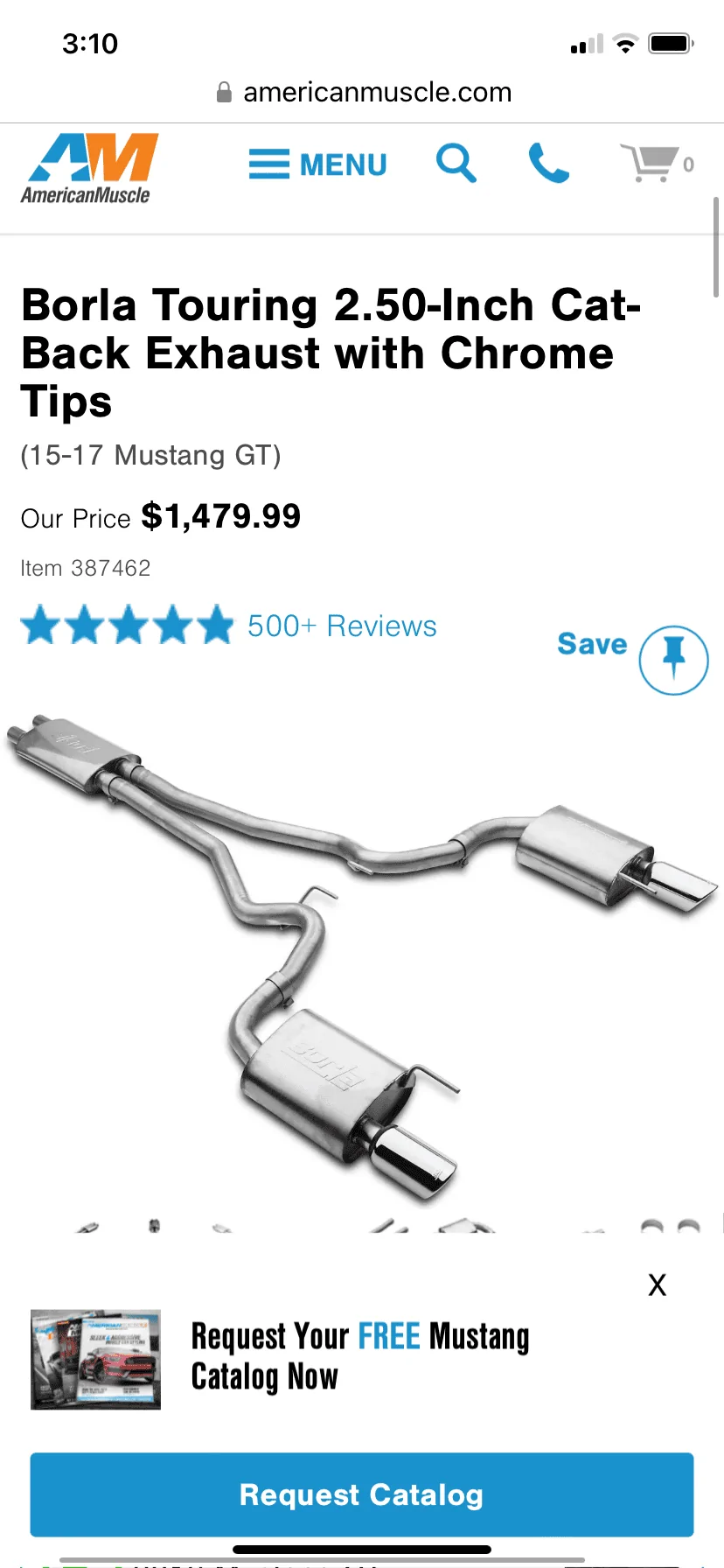

I now run the Borla Touring system. Basically a 3 muffler system. I’m catless and still have the 2 1/4” neck downs at the connections. I love this exhaust. Most younger drivers complain it’s too quiet, but I think it’s perfect and I can make it very quiet with little to no load.

is it the sport or touring? I don’t remember what they call it. And I was looking at the awe touring some videos it sounds not to loud and others it does.

i don’t wanna chop anything up I would rather just buy the right one.

This one.
