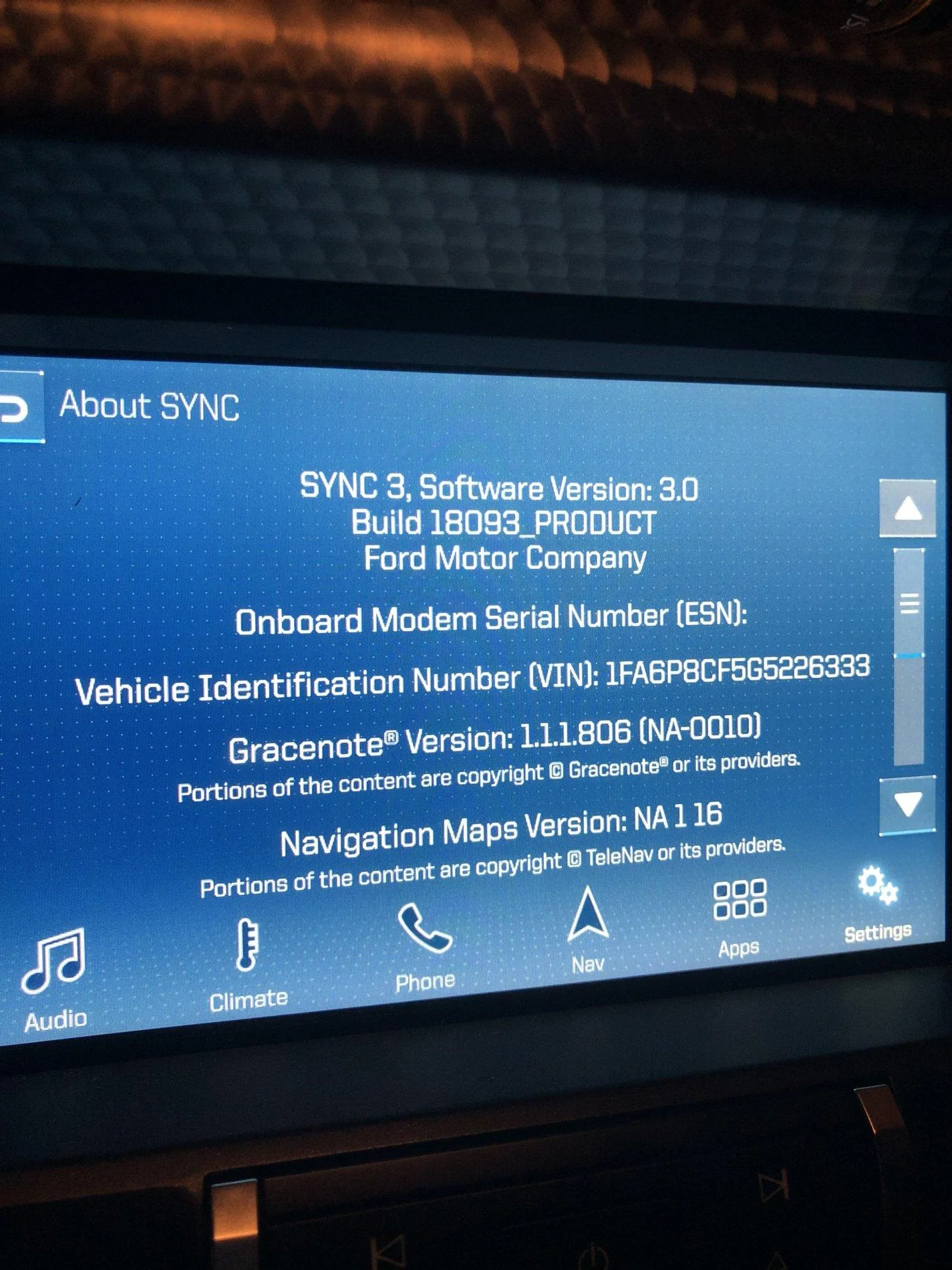

Currently the only way to update built in maps is to change out our APIM from a newer model. I’ll be doing this adding 18 maps along with HD radio.

Find an APIM from a salvaged 2018. I did for under a $100 and you can see my vin which clearly says it’s a 2016 but I have 2018 maps which is the NA 1 16 (previously was NA 1 14). It even apparently had a modem which I don’t have. Easy install and a little forscan coding. This of course if you wish upgraded maps that bad. I appreciate not being on ghost roads in my area anymore as well as finding some places that seem like they have been there forever which amazingly now are in my maps. And there’s always Waze, Apple and Google maps.
