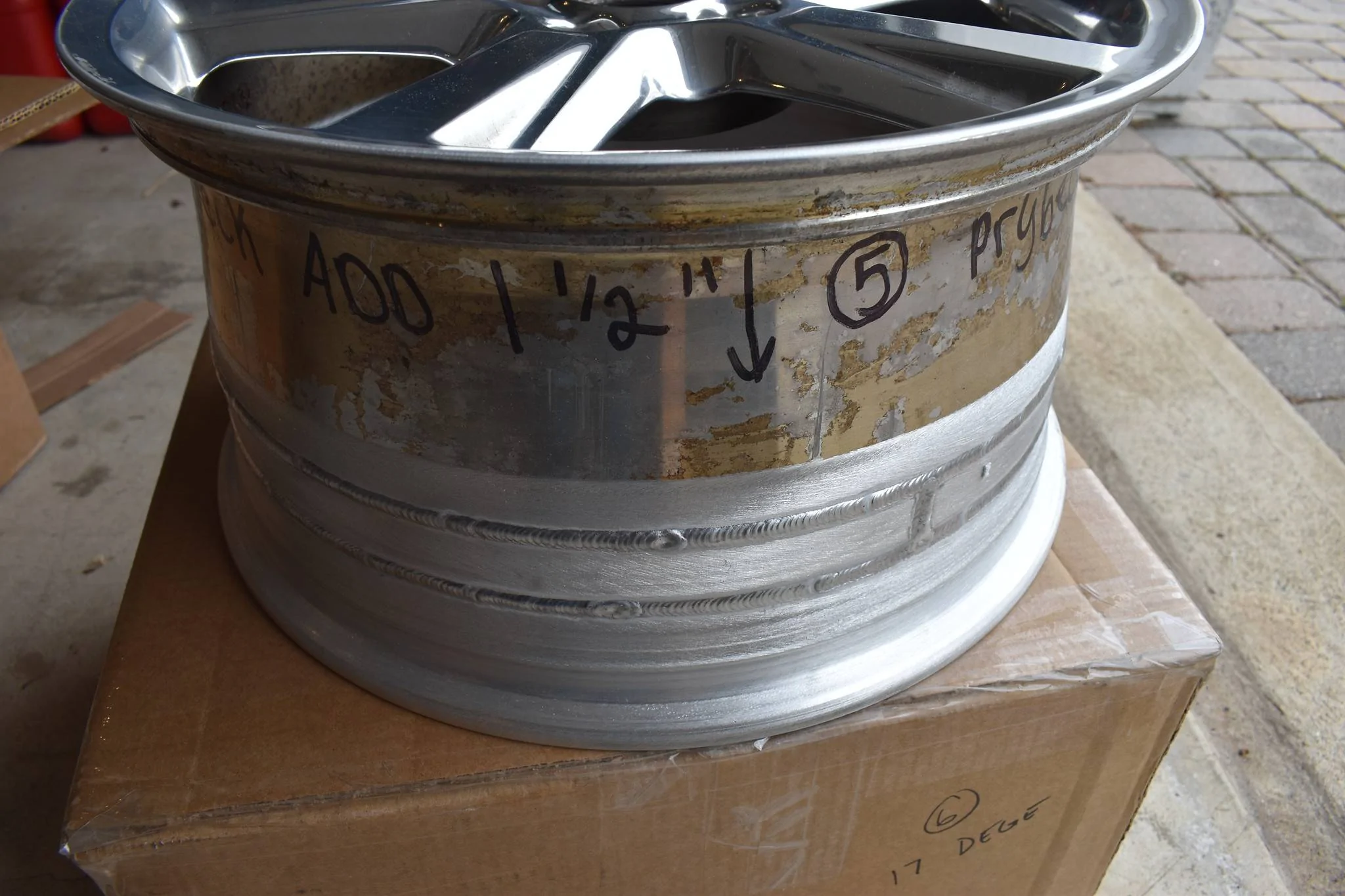

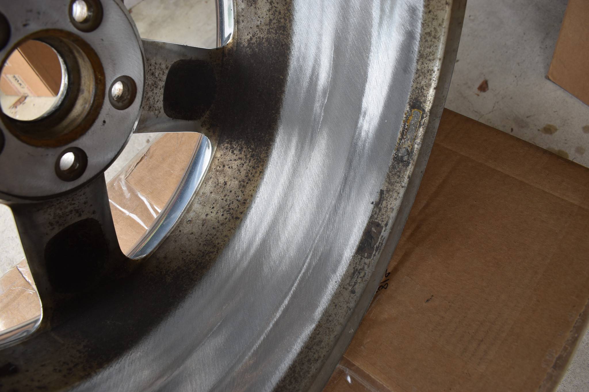

So I'm thinking of adding power to my 15' but I really like my Roush rims. The rims rims are 20x9.5, which won't cut it. Has anyone widened a Roush rim in the back? I was thinking of sending them to weldcraft to widen them to 20x11. Thoughts? I currently have spacers on the rear (which I would need). Wheels sit nice and flush. (I have the ford performance rear hubs with the longer studs). This is all purely cosmetic. I'm not tracking the car or racing it. If anyone has done it I would love to see pics.

I used Weldcraft years ago on a previous car, and while it worked out fine never had any issues I would not do it again mainly due to cost. I would keep the OEM Roush wheels as is and get another pair for looks. With wheels being so cheap these days, it's not worth it to go through all the trouble of cutting and welding a nice pair of wheels.

I say do it if you like the look of those wheels. I have a set of Weld Magnums that were originally made for the irs cobras and supras. They were originally 17x9.25. Weldcraft widened them 3". Only set in the world I know of on a S550. The extra width puts all of the 325/45/17 M&H tread on the ground and looks awesome. Weldcraft does excellent work and I've never had an issue getting tire shops to mount them.

I had weldcraft widen a set of marauder wheels, all the marauder guys who are looking for widened stock wheels go to weldcraft. They do excellent work for sure
