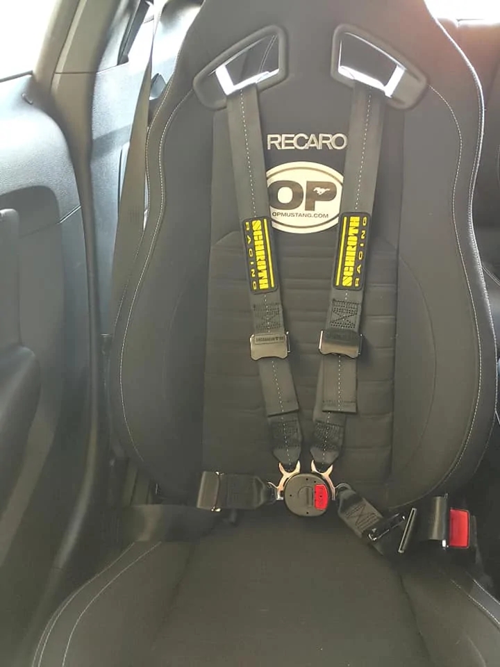

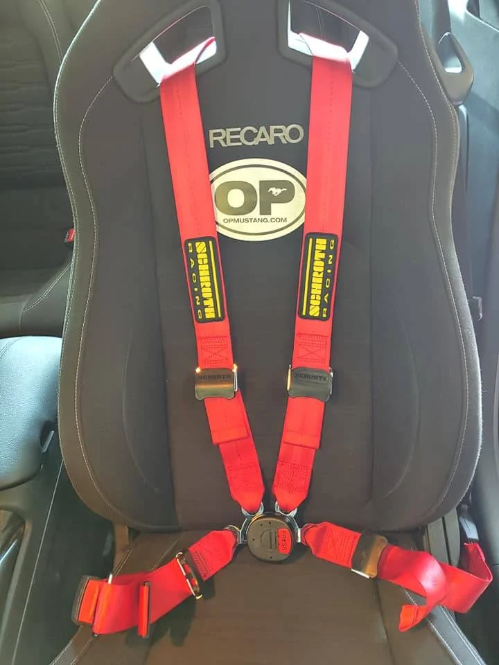

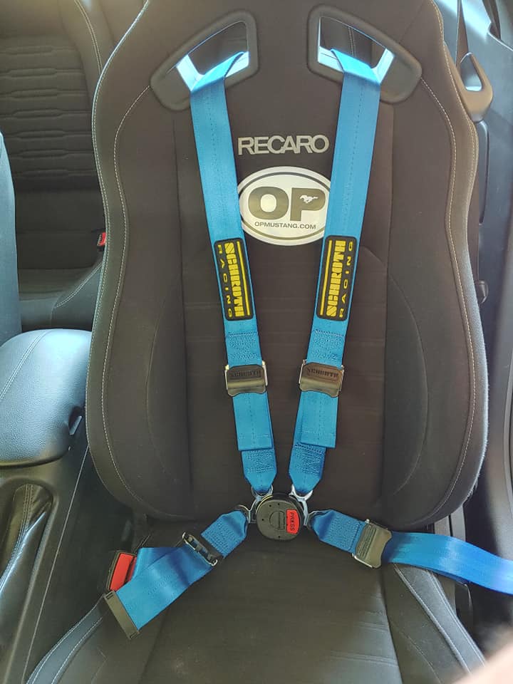

We usually stock these colors. They are 100% DOT legal, but recommend running the 3 point on the street, use a HANS device and they are only certified with the Factory seats. They can be used will a roll bar, you just run the shoulder belts over the cross bar to the rear attachment points, not to the bar.
Life changing how much more control you have when you do not fall out of the seat.
