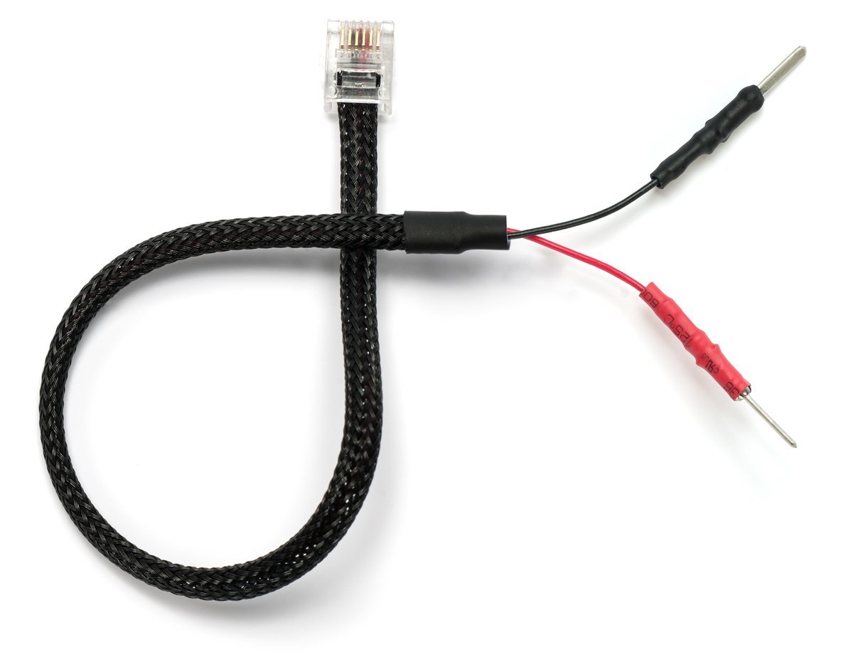

I'm sure there are tons of people with hardwired radar detectors - so i'm looking to hear how you did it.
Personally, I picked up one of these wires, hooked it into my V1, and then used the prongs on the back of the mirror. The problem is, those prongs hold no stable connection, I pretty much need to jam it into the only power socket going in, digging up the wire coating probably which will eventually completely rip up the wire. Any warm day, the coating gets soft and my prong loses connectivity, so i have to jam it in again, and rinse/repeat almost every day with both power and ground.
I know that doing this is going to wear down the wire i'm trying to vampire off of with my little prong, so i'm hoping there's a better way to use this thing, or just a completely better alternative.
Here is the wire I've been using:

Interesting. What does that connect to? I don't recognize anything from that :p
Do those prongs just attach to your mirror also? If so, how do they get connectivity to the power/ground without hacking up the wires feeding those connections (like I'm doing in my description)

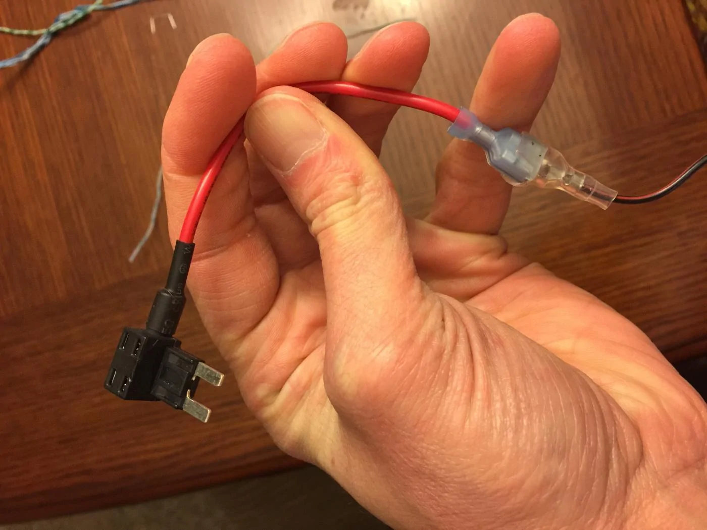

NewTekBuzz
Mar 21, 2015
115
1,157
173
Flint, MI
Tim
2019 velocity blue GT 6M - 2015 Black GT 6M (sold)
No sorry, that runs back to the fuse panel and piggybacks a fuse of your choose

I used this connector for my V1. I installed it a year ago and it works great.
I'm sure the connector is great, I fear I'm just not using it correctly. How do you connect the prongs for power? Do you cram it in the mirror sockets that have wires already going in? That's the only way I've found sockets with power, which when you cram the prong in, its digging up those wires every time...
I have mine done this way for Escort Max2. The prongs are very difficult to insert (at least in my experience).
