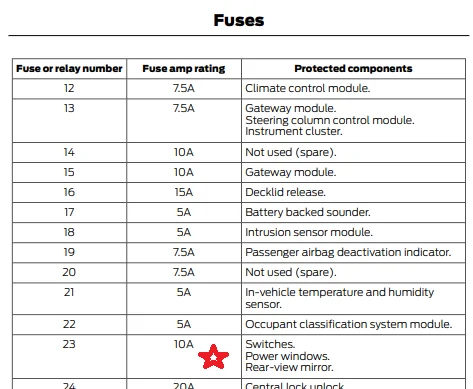

A quick look in the owners manual shows the rear view mirror+switches+power windows share fuse #23 which is a 10-amp

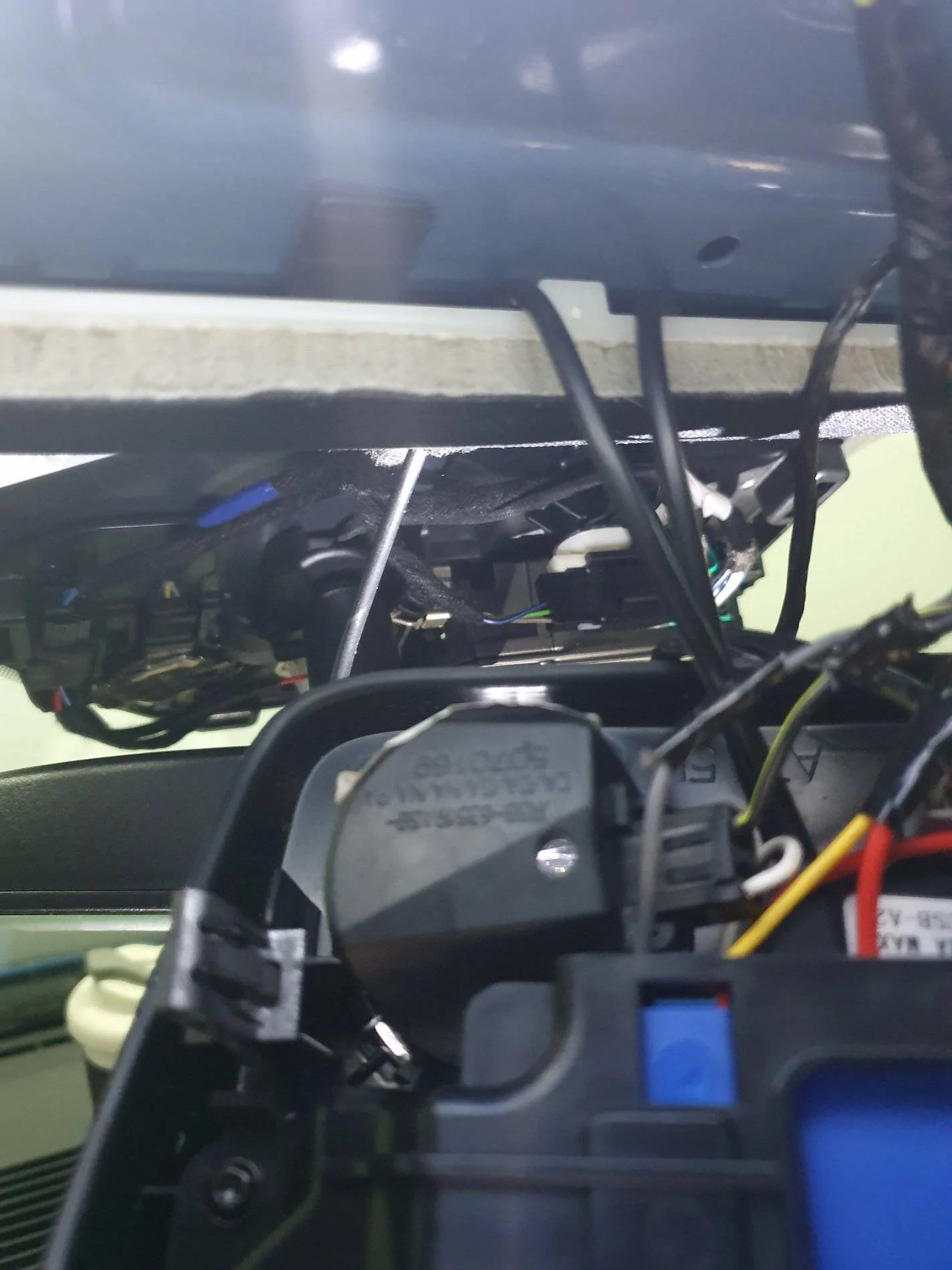

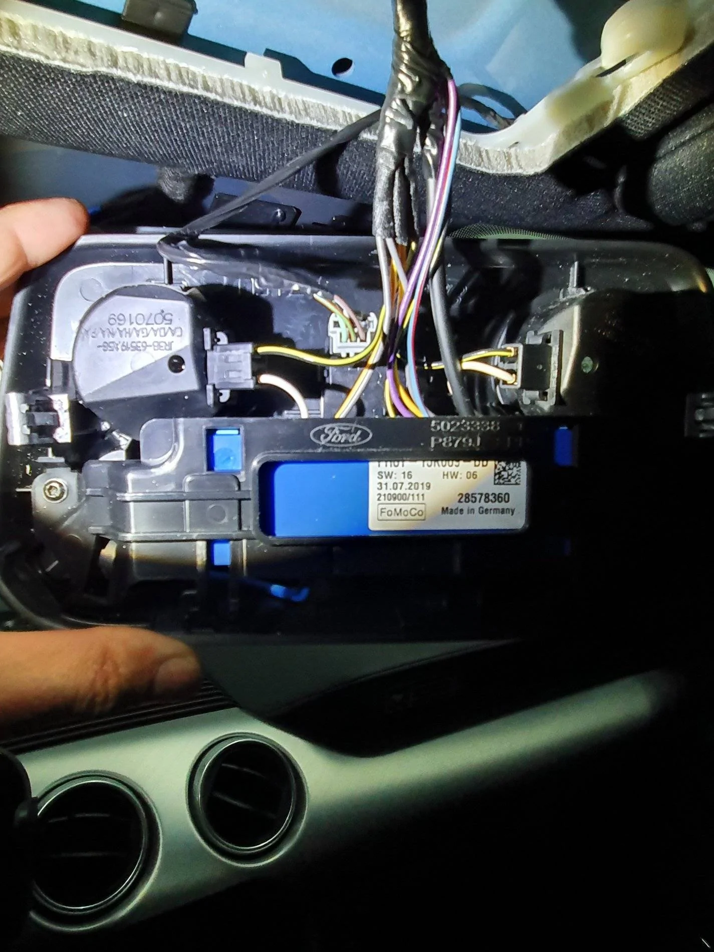

If anyone else is interested: there are three wires going to each of the two the maplight buttons. It's the yellow wire that is powered after unlocking the car or driving. It powers off about 10 minutes after the ignition turns off on my car.
I connected my small 12v -> 5v step down unit to that yellow wire for "live", and to the black/yellow wire that goes into the lightbulb casing for ground:

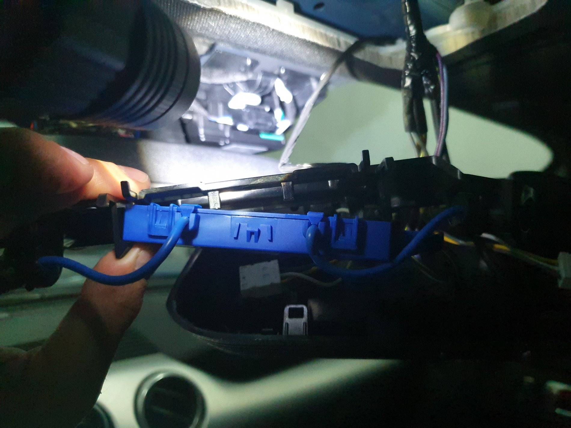

After I unscrewed the blue rectangular box in the maplight casing I could fit my 12v -> 5v converter under it, with a small amount of double sided tape to help hold it in place while I screwed the blue box back on:
Need something to unscrew the two T10 torx screews to take it off.

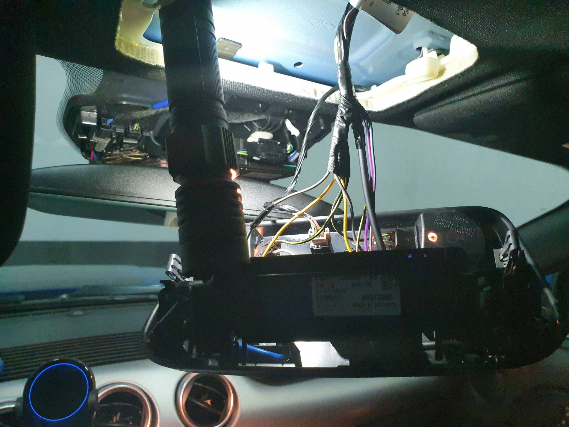

I then routed the female/input usb sockets coming out from the 12v -> 5v step down unit out under the roof lining between the maplight box and the rearview mirror:
From there it's just a few centimeters to connect the dash cam that I currently have attached via a clamp to the rod going from the rearview mirror.
Improvements if I were to do it again:
- I think maybe I would not have needed to take off the whole rearview mirror casing. Possibly it would be enough to take of just the small part in the middle where the rod from the rearview mirror goes into the case, but I had already taken it of before I read your idea to get power from the maplight box instead. Anyway, compared to the maplight case, the rearview mirror casing is easy to take of as long as one has some plastic tools to insert between the casing and the roof.
