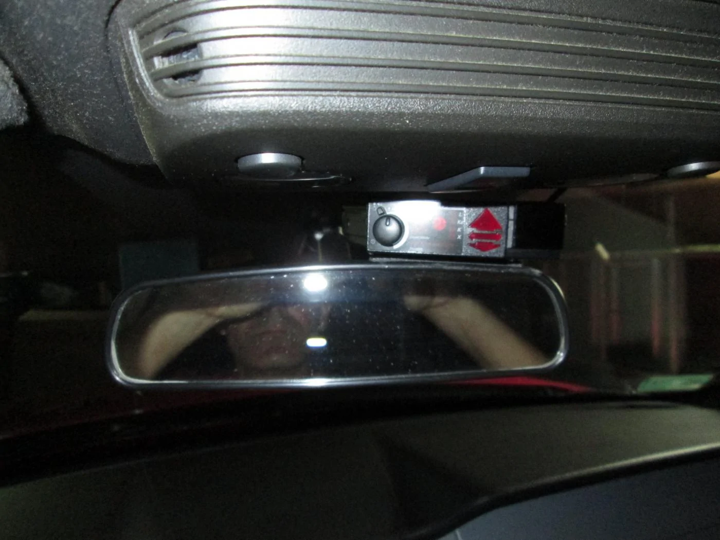

Would you mind posting a photo of your setup?
Looking around, it looks like there are lots of ways to make a V1 more expensive. I'm trying to figure out which would be the most reasonable solution. I've also been thinking of adding a dash cam, but I'm very much not interested in having a bunch of clutter on my windshield so figuring out how best to tuck things away is important.

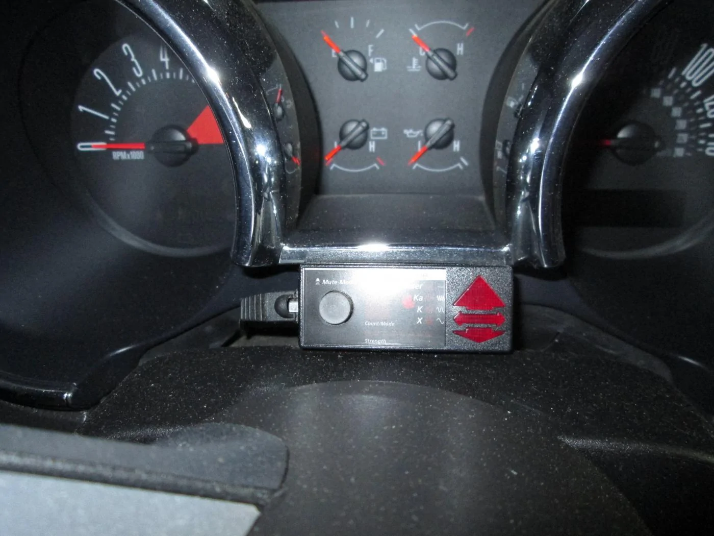

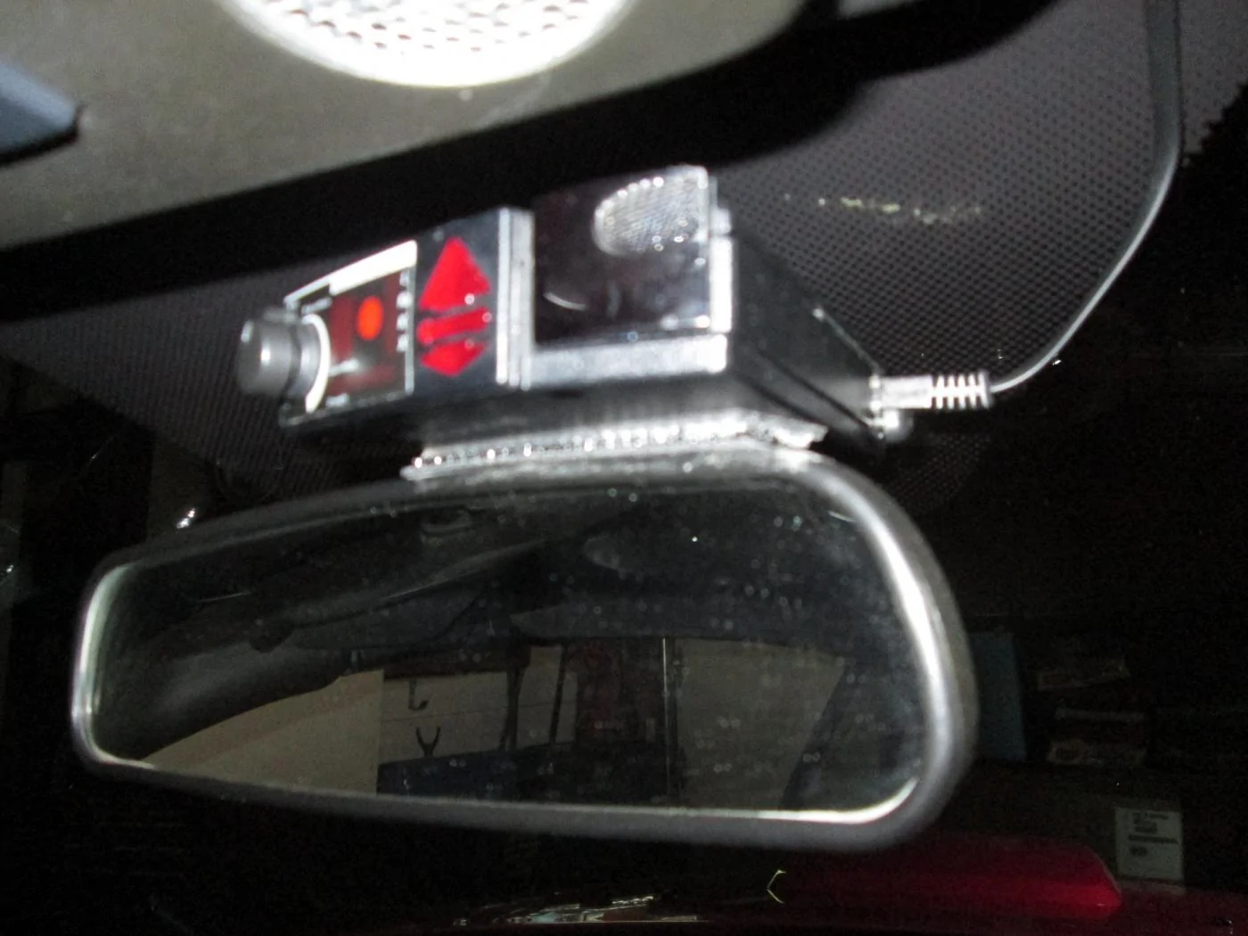

Sure, here's my setup. It cost all of $4 for heavy duty velcro. I like the idea of the blend mounts but there's an awful lot of hardware there that looks clunky to me, but the worst part for me is that it hangs down below the mirror and announces itself to thieves and police. The way I have mine mounted it's tucked above the mirror (basically hitting the windshield header panel when I have my mirror adjusted properly) so it's hidden when I'm driving and doesn't announce itself to crooks if I leave it mounted in the car. You can see it if you crouch down and look up for it, but you won't see it if you walk by and casually look.
The concealed display is about $39 if I remember right and I have that mounted in the dash between the gauges. Keeps everything dark above so there's no display to be seen by people following from behind.
My son has a similar set up in his '97 Cobra hardtop. Escort 9500 clipped to the visor with the remote display installed in place of the factory coin holder in the console. That's pretty slick too.

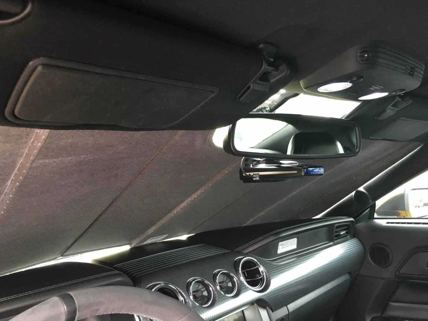

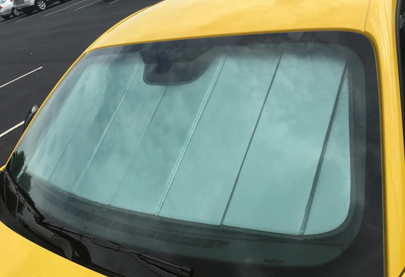

Question, are you able use a sun shade with your escort and blend mount.
Can anyone else confirm?
BTW thanks for the detailed pics. Really want to get this setup.
No problem. Sunshade fits same as if nothing were there.

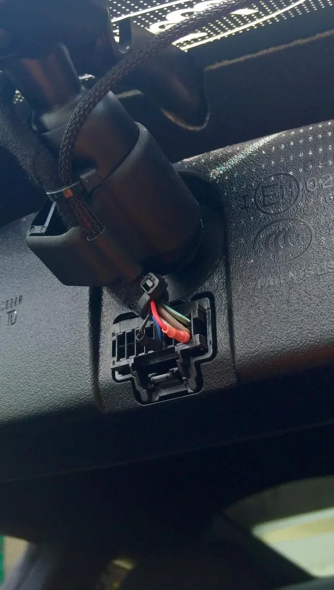

I didn't take pictures but I ended up cutting the electrode on my kit in half with some small wire cutters to get them to fit better. I haven't had an issue in over a year since doing so.

Here's a pic of mine I got the smaller sized ones can't remember I believe .25.
It literally took 30 seconds. If they're not fitting you probably got the longer ones.
