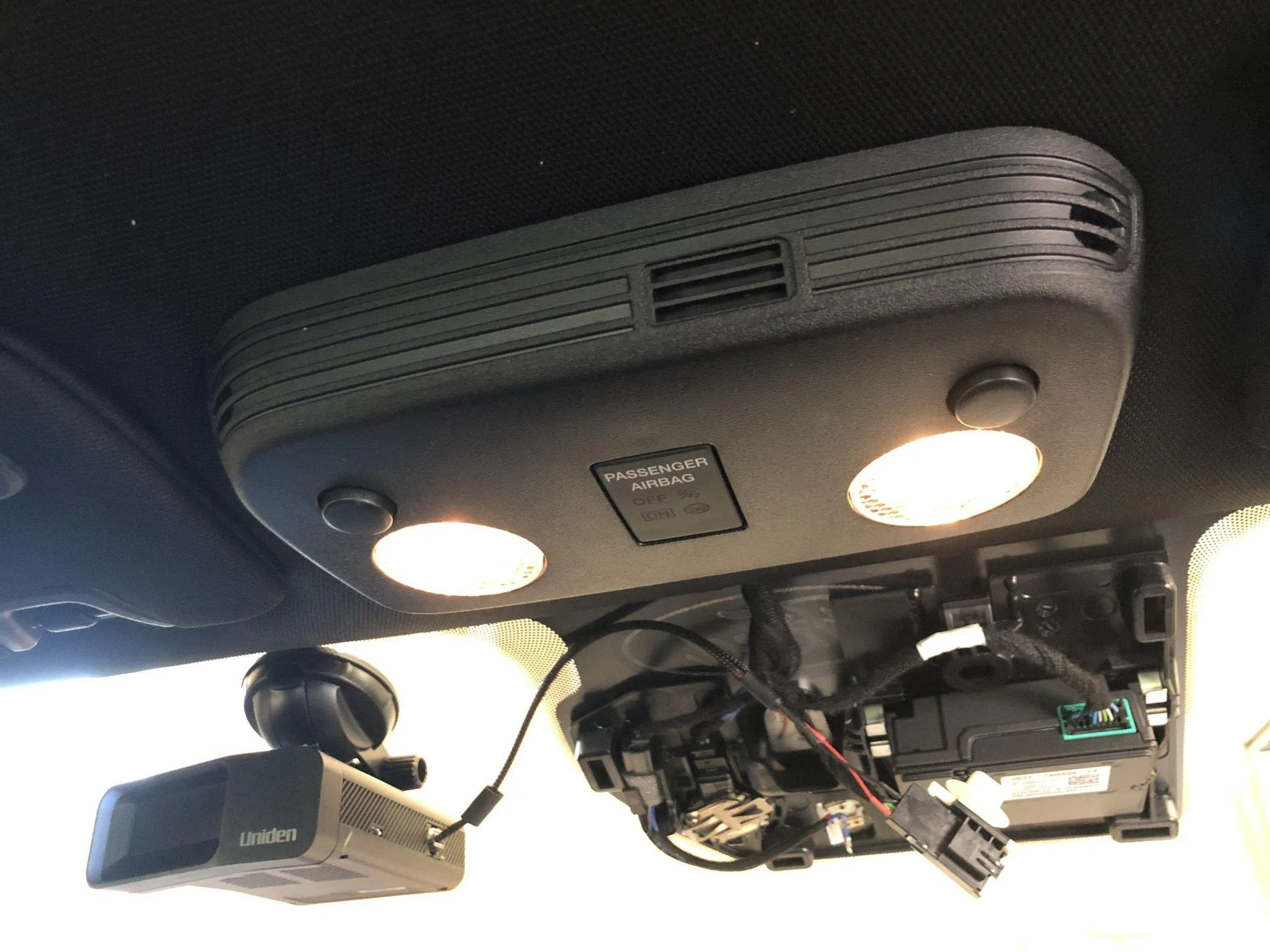

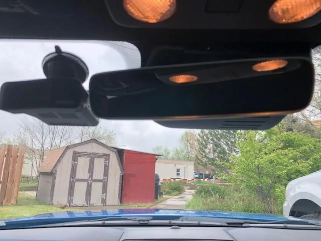

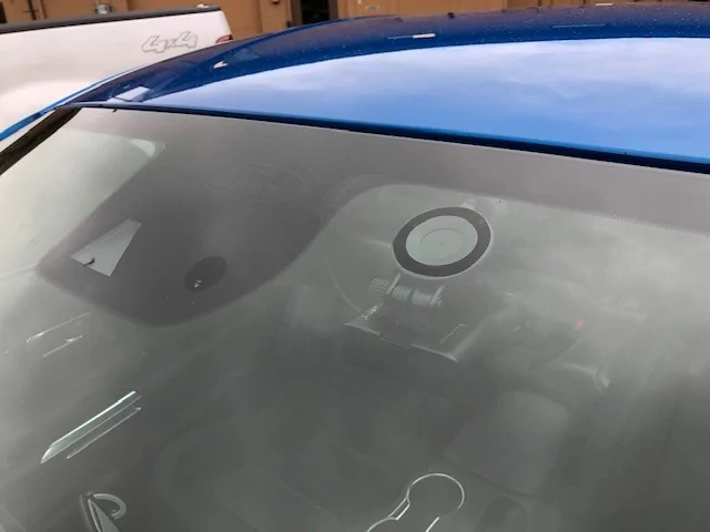

    Based on the information in this thread (Thanks GTFURY and Enzo), I bought a Uniden R7 and the MirrorTap MTX-1010 kit and did the install.
    A few thoughts:
    • Removing the cover was initially a little disconcerting, like you were going to break something. Just go for it. As the pic above shows, there are clips and the cover snaps off no problem with a little effort
    • The mirror tap kit has multiple tips that plug into the harness that account for installation in different cars. This was a little tricky getting the right one to fit and not be too loose.
    • I found the actual mirror tab cable with the RJ11 connector to be a tad short. Another couple of inches would have been better. It works, and will work better when I get the blend mount, but for the suction cup mounts it doesn't give you a lot of options (see picture below).
    Here are some not so great pictures of the install.
    Hope this helps others.
