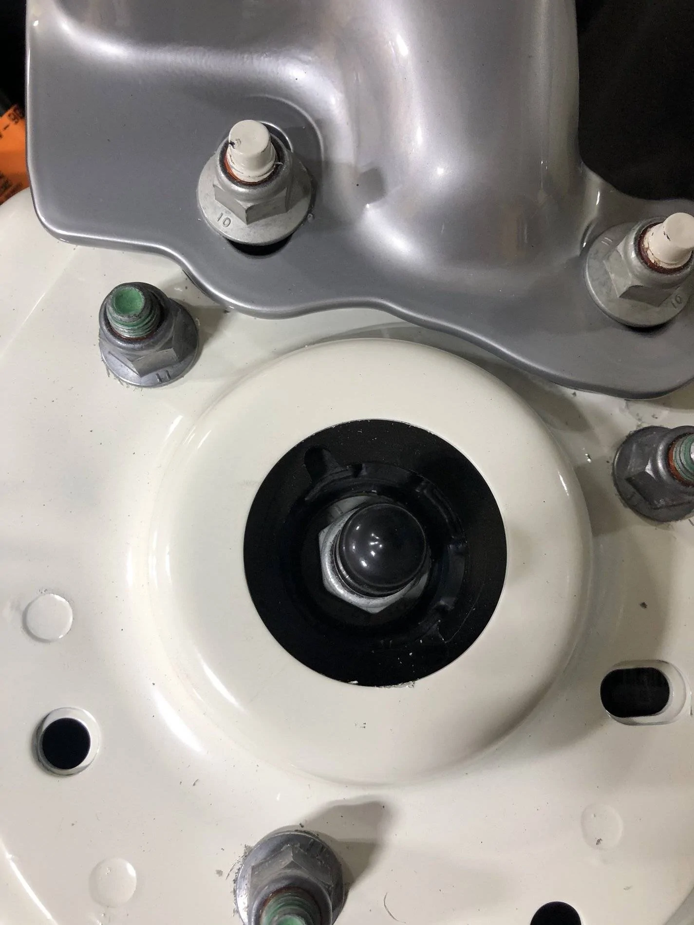

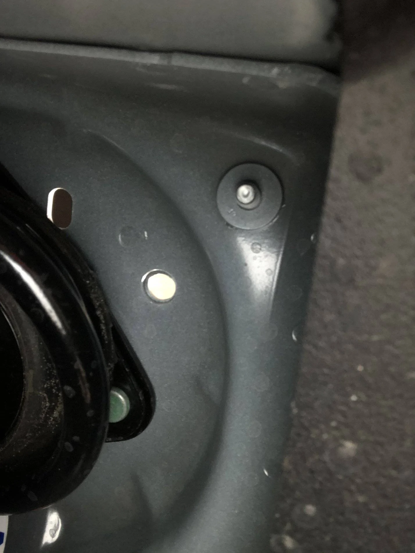

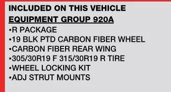

I know there are a couple threads on this, but the ones i found are dated. I have seen comments on different ways they are doing the camber plates for the handling pack. Some have said they come in the trunk, others say they are shipped separate to the dealer, and have others say they are installed at the factory. So has anyone recently received their car with this pack and can verify what was done?
I just picked up my car last night and do not think the adjustable are installed, loosened the 3 bolts and I had no movement. I Jacked the car up and looked with the wheel on, so not the best look, but does not look like there is an adjustment plate. Last week I just installed Maximum Motorsports camber plates on a buddies PP2 car so have an idea of what I should be looking for.
Just looking for someone with a recent purchase to see what was done exactly, my produced date was last week of July or first week of August. Dealership said there was not a box in the car, and they have not received any camber plates or covers all year to their parts department for these cars. I spoke to a different dealership and he thought they come in the car and will install per customer request. I reached out to someone on the ford performance parts website and he thought they were installed at the factory, and I sent him some pics and waiting to hear back from him.
I have a few pics below, let me know your thoughts.

Yeah, no camber plates in those pics, looks like the normal strut top mounts to me.
The Ford site says they are a factory-invoiced accessory that ships separately and is installed by the dealer, so there you go.

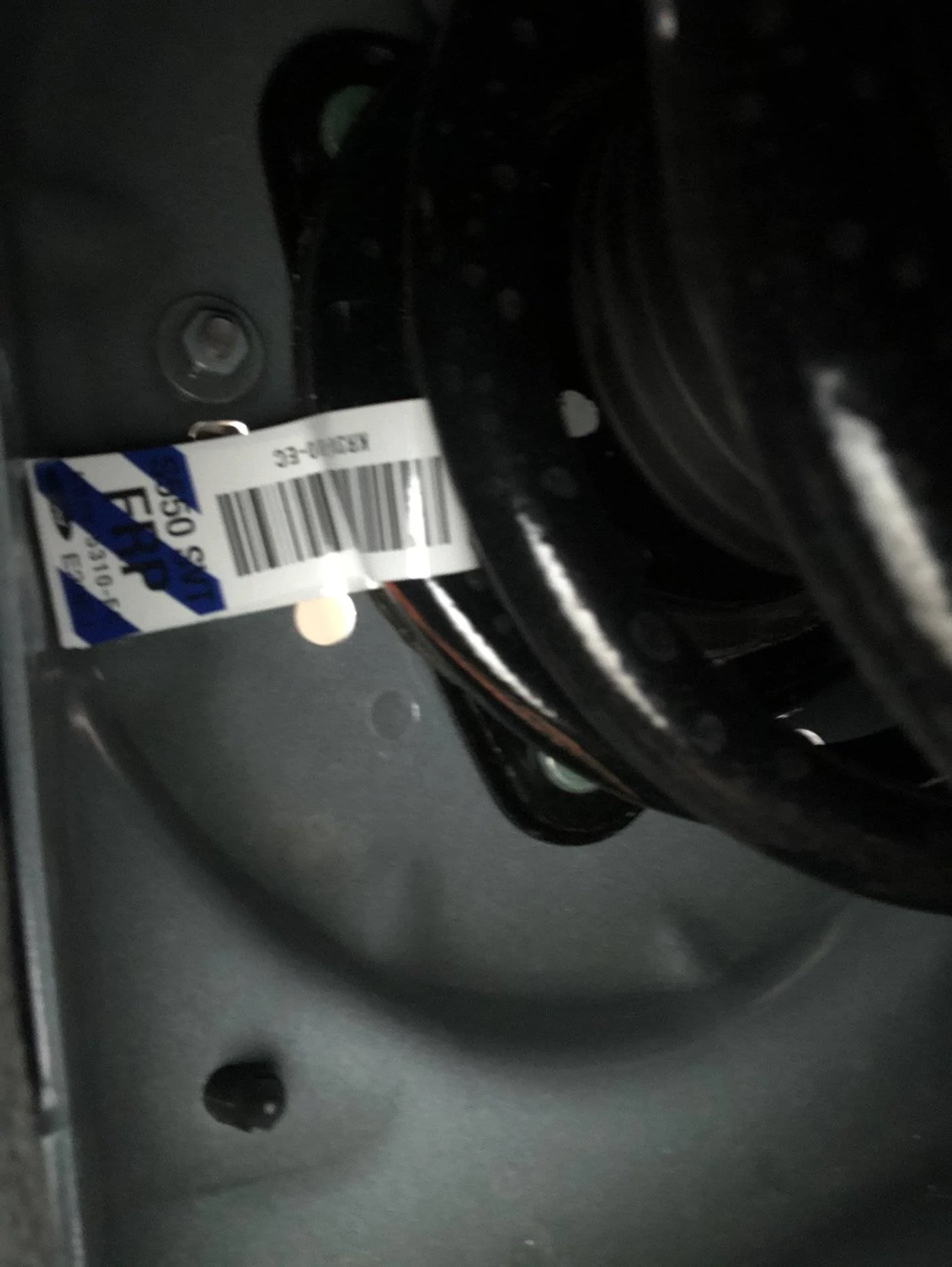

My HEP R sticker says this:
The R comes with them standard, and I'd think they'd be installed at the factory in that case. The non-R 350 doesn't come with them standard, they come with the handling package tho, and it clearly says on the build site that the parts ship to the dealer separately for install by the dealer.

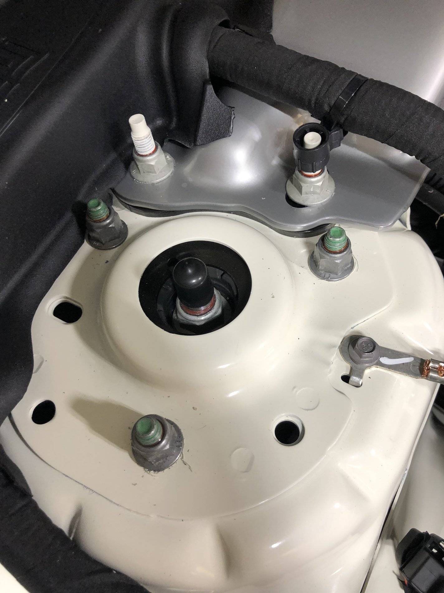

The video is good. Seeing both side by side top and bottom I know 100% they are not adjustable. I was trying to not jump to conclusions to quick. I will get back with the dealer. Crap deal is, I had previously signed up for an event in a week and a half and didn't expect to have to do this. Luckily my buddy was accidentally shipped two sets of maximum Motorsports plates so may just buy those and throw those on and make the dealership do the alignment. I feel I may get more adjustment from the maximum Motorsports one anyways.
