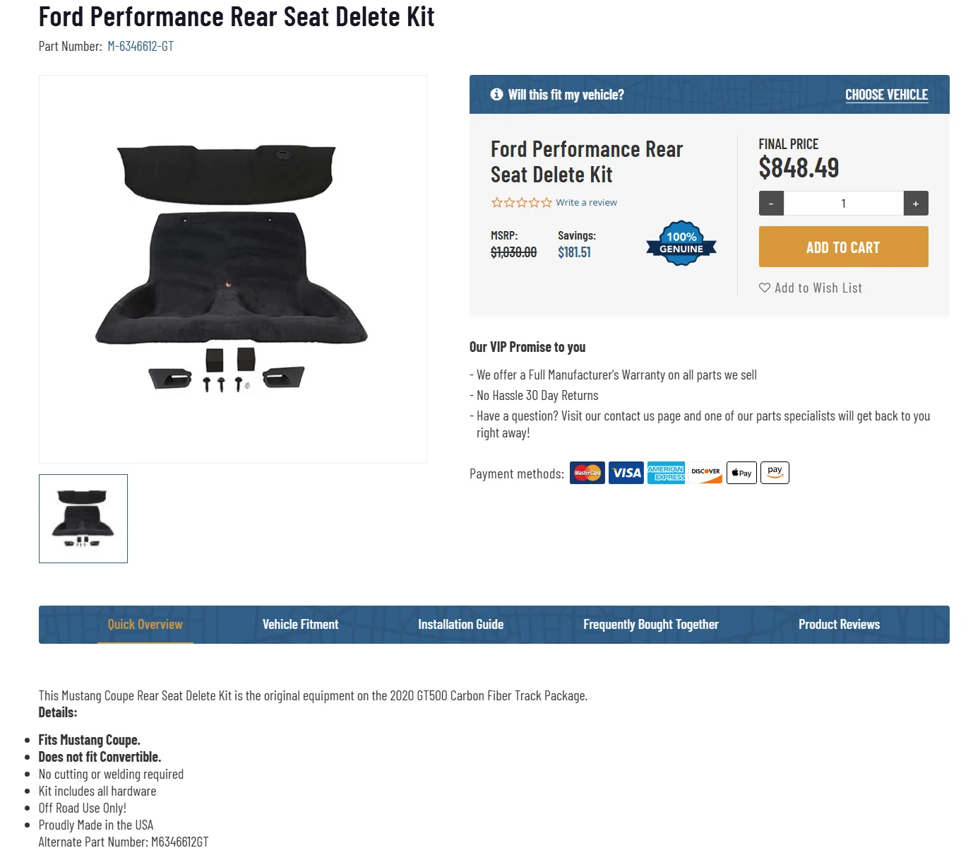

Does anyone have this on a Mach 1? Depending on the company selling it some say it cannot be used on 2021+ cars but some do not mention it.

If I remember correctly from other posts on this forum, it has to do with the rear seat belts in the 2021+ Mach 1's, they have a sensor on them. The kit has you remove the seat belts and if you do and unplug the sensor, the seatbelt light on your dash stays on. I believe some people on here have just left that one part of the seatbelt in place and made sure it was secure under the panel.

I have it but mine was from the factory. I second what was said that I believe some people secure it under the panel.
Blows my mind how much they charge for those things. Would love to do a custom option with like a leather shelf/panel

For what the aftermarket charges for ABS plastic delete kits, the ripoff pricing is all relative. The factory delete option eliminates the tapped holes to mount seat belts and might also use a different side air bag to omit rear coverage. I wanted to order a rear seat delete option (and should have) for my 2022 Mach 1 but I just couldn't stomach paying extra for less content. I had to leave the rear seat belt buckles installed to keep the BCM happy when I deleted my rear seat. I don't have Forscan to monkey with the BCM settings and it's possible Ford doesn't even allow access to some of the SRS settings?
