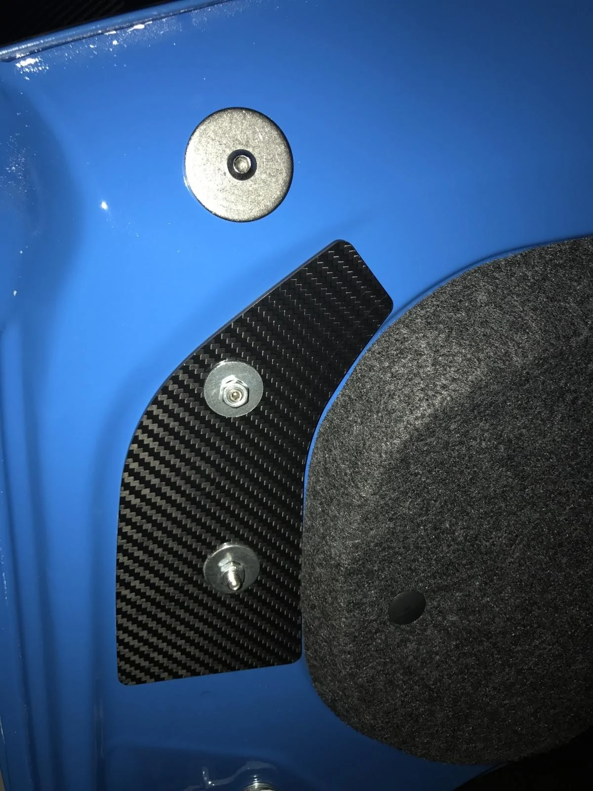

For anyone interested in the APR GT-250 wing, this is how it mounts under the trunk at each side. That plate is a quarter inch thick.
My car has seen 160 mph with the wing and I will say that the front corners of the trunk seem just a tiny bit higher than the body of the car where they meet. I can't remember if this is how it has always been (misalignment) or if it was a product of the downforce produced by the wing.

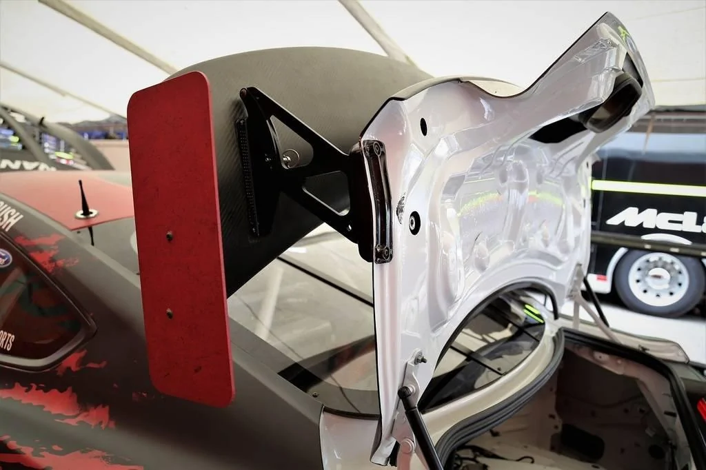

I've shared it elsewhere so it isn't anything new - the GT350R wing supplier is Multimatic in Markham, Ontario. That said, they don't sell the hardware (or wing) direct to the public. Chris is being careful in respecting the wishes of those that helped direct him on this one and I can respect that as I did the same. It's too bad it has to be this way but it is what it is.
For those that truly on the hunt I suggest you contact Dean Martin at Kohr Racing. The GT4 cars use a custom wing atop the rear decklid but use the R model dogbones to attach them underneath.
Also of note - the factory hardware is metric to match the wing. The C2C wing, for example, uses an SAE thread.
