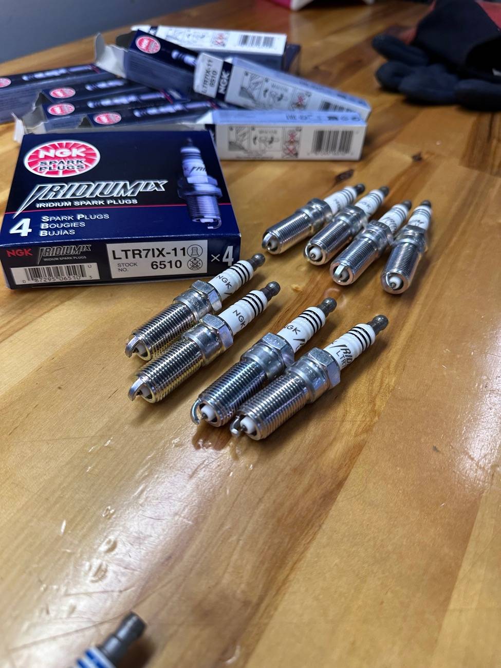

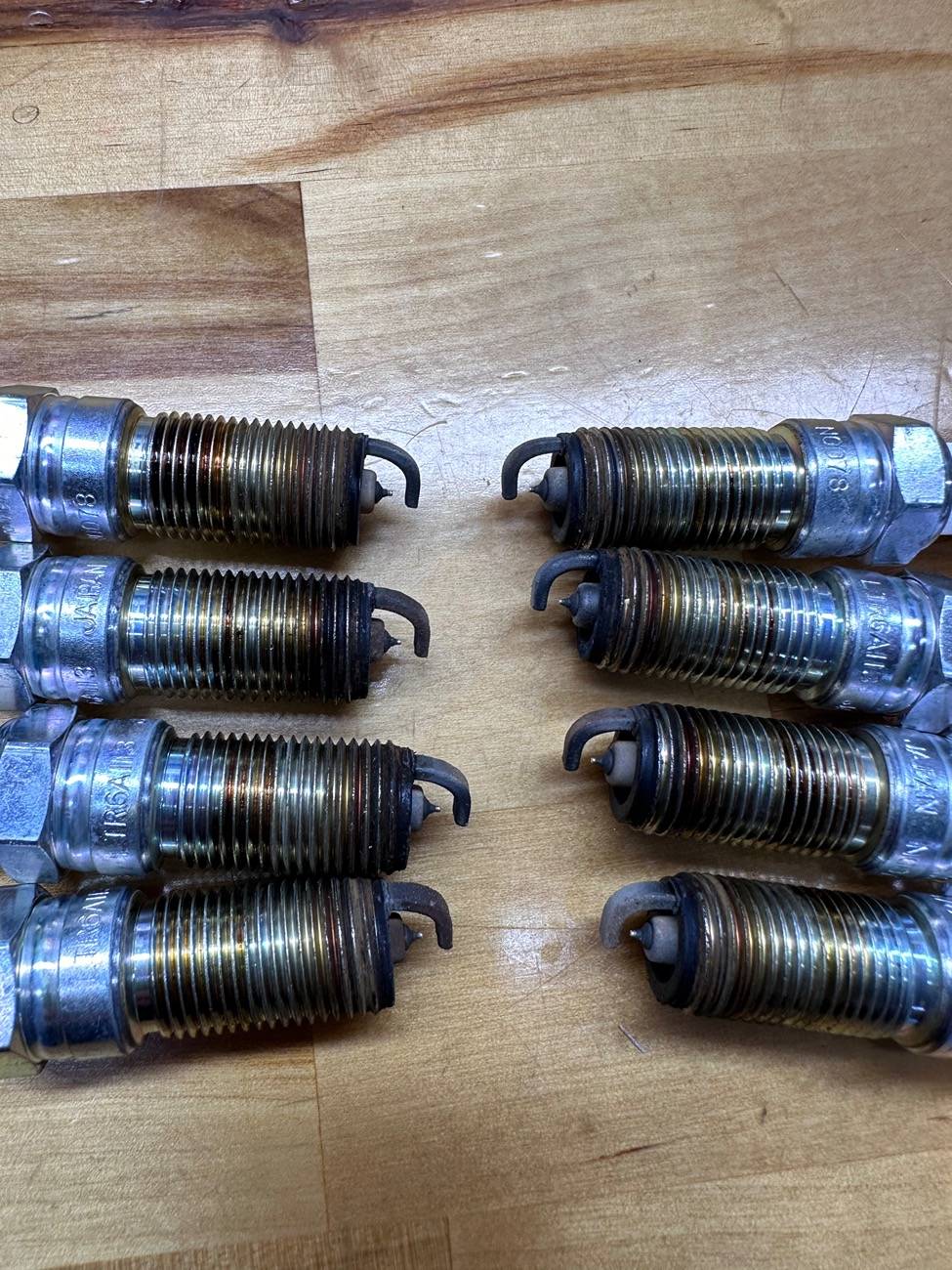

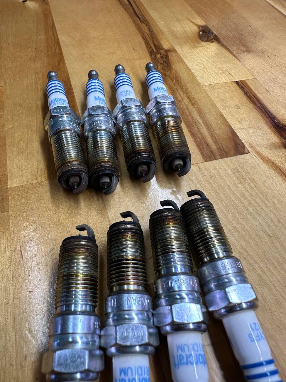

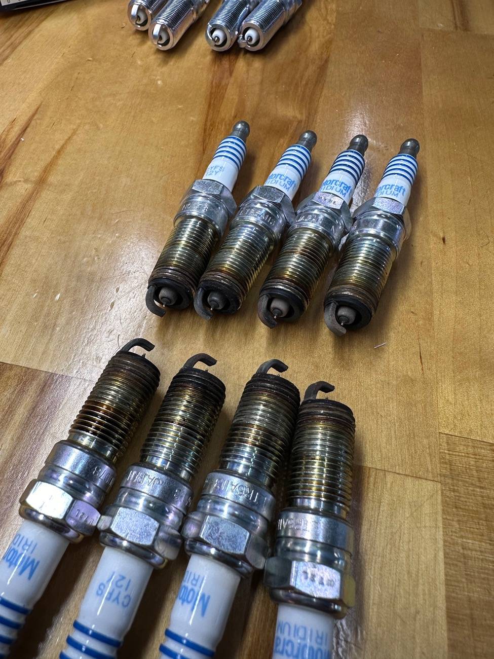

Out with the old-in with the new at 35,000. I don’t see anything disturbing here; you guys? 4 and 8 look as similar as all the others.
Stock plugs were pretty darn consistently gaped at .052 - .054”.
I figured since the the plug gap was updated, the new ones are going in as gapped out of the box. NGK’s QA is petty good. All eight were pretty much spot on gap at .040” by my gauge.
4 8
3 7
2 6
1 5
8 7 6 5
1 2 3 4
