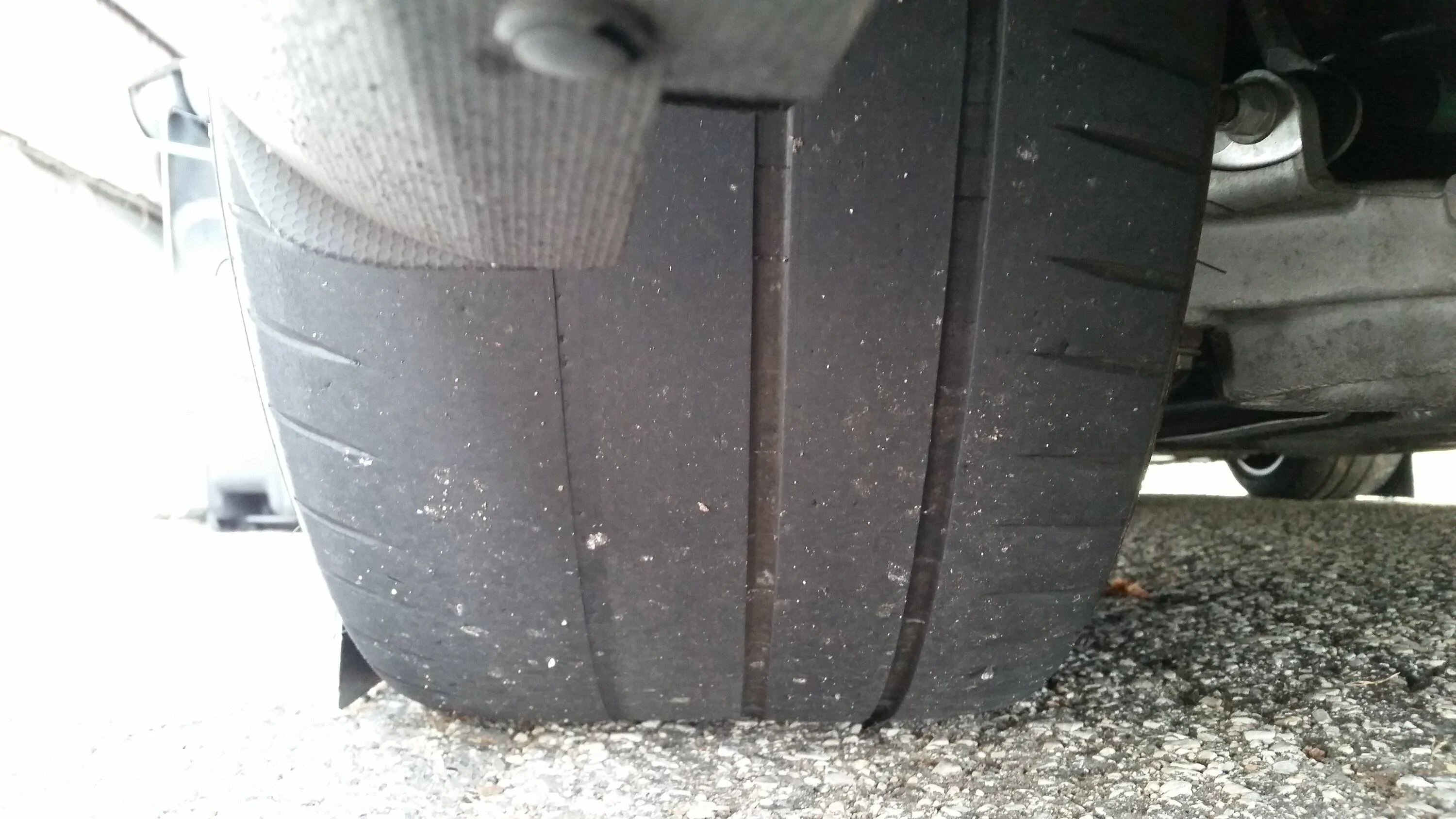

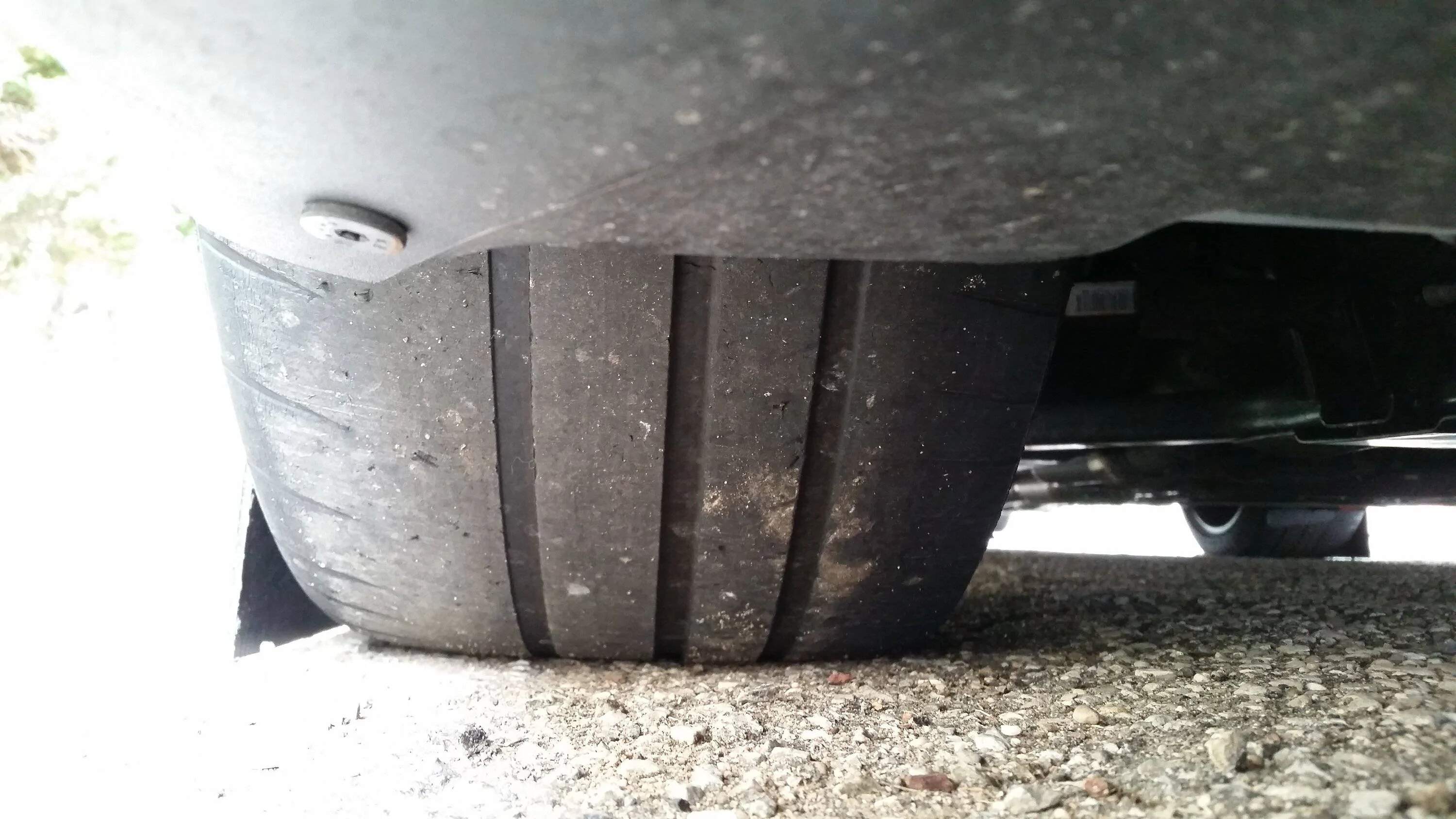

The rear tires do wear faster than the fronts. And the SC2's wear from the outside in. Meaning the grooves starting from the outside will disappear first, with the inside groove being last. As long as the inside groove is stiil above the wear bars, or about 3/32", tires are still gtg. These were my front and rear tires with about 10k miles on them. I now have about 12K miles, and will be changing them by May, mainly because I'll be making a trip from NY to NC. At that point they should be at the end of their life.
