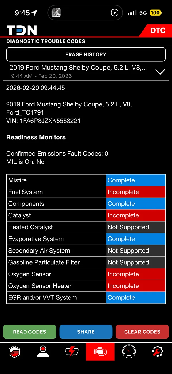

I have a 2019 GT350 with a couple of bolt ons - JLT CAI, Soler 95mm throttle body, Fabspeed sport cats, and a Borla Atak exhaust with x pipe.
I recently got a Wengerd tune, as I've heard nothing but great things about them but have had multiple issues. We had issues loading the tunes that I won't get into. Issue resolved - no big deal.

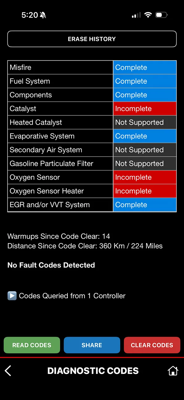

However, I've put several hundred miles on the car and probably a dozen drive cycles and mutiple systems show a status of INCOMPLETE. I've been told that putting the car through various drive cycles will eventually replace those issues.
I am getting a P0430 code, which indicates an issue with the cats on bank2. This is very concerning since I just paid a ton of money for the sport cats 3 months ago and would be very disappointed if one went bad already.
I have read multiple solutions but want some feedback l from the community. Should the tune be tweaked to adjust for the P0430 code? Do I have a bad 02 sensor? Can I just install an 02 spacer to make the code go away (not sure if this is just masking an issue that should be addressed)?
I'm currently not receiving any response from Wengerd and not sure if I should reach out to Fabspeed. The cats performed flawlessly with no CEL until I put the tune on the car.
Any help or advice would be greatly appreciated.

That's great news. Which O2 spacers are you using? Will the O2 spacers also allow the Oxygen Sensor and Oxygen Sensor Heater systems to clear for an inspection?

That's awesome. Thanks so much for your help. I'm buying them now. I'll report back if it fixes my issues after I get them on the car.

I ended up putting in the spacers as well. I was able to make my own from a thread found on the forums here. No CEL since.
