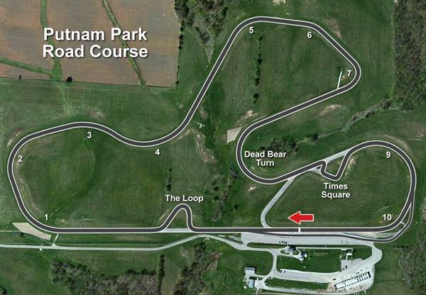

I've tried both 2nd and 3rd gears in Turn 7 at Putnam Park, and I find that I get a lot better acceleration coming out of the turn if I downshift to 2nd... I'm in the powerband much earlier.
However, to @EFI's point, I'm also on sticky tires (Hoosier R7's or Goodyear Supercar 3R's), so traction isn't an issue for me in that corner on most days.
