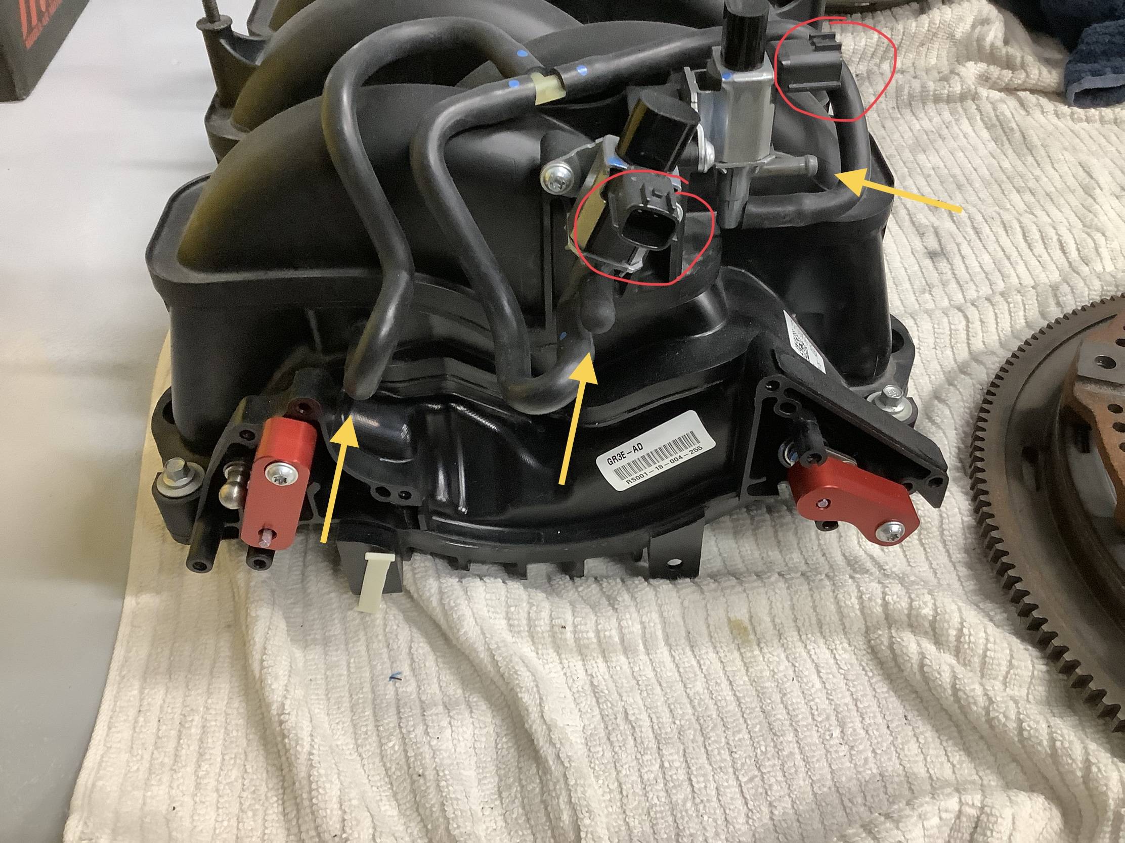

Has anyone done an imrc lockout on a gt350 manifold?? I’m not sure what to do with all the vaccum line and desperately need help

On a 15 there is no need to lock them out. It's plug and play. If you have your heart set on locking them out plug every vacuum port except for the brake booster and the PCV valve.

This is how I did mine. I sure hope it’s right. I’m going to plug up the two electrical connectors (circled in red), to keep them water tight. I’m also looking for dust covers for the remaining two connectors. The The factory vacuum hose and/or caps will be connected to the ports identified by yellow arrows.
