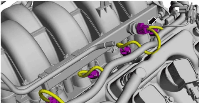

@mallard8 you sure the fuel rail pressure sensor is plugged in? You mentioned that you kept getting a P008A.

checked the injectors, looks like I've got the ford performance 47 LB. I wasn't sure what you meant by holes.
What he meant by holes is the bottom part of the injector has holes that the fuel will spray out of.
