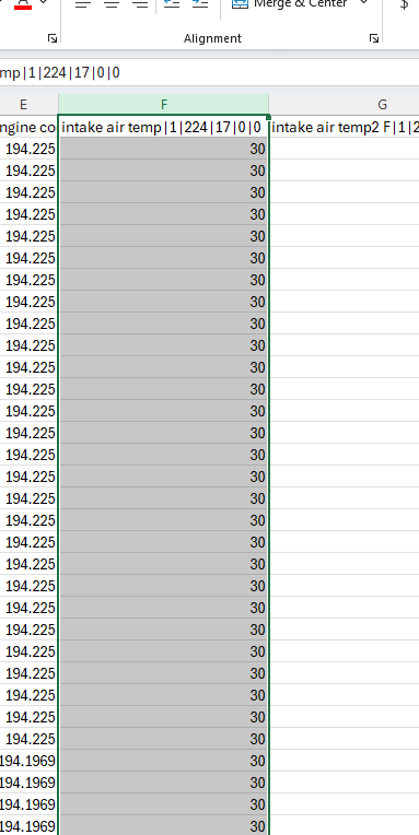

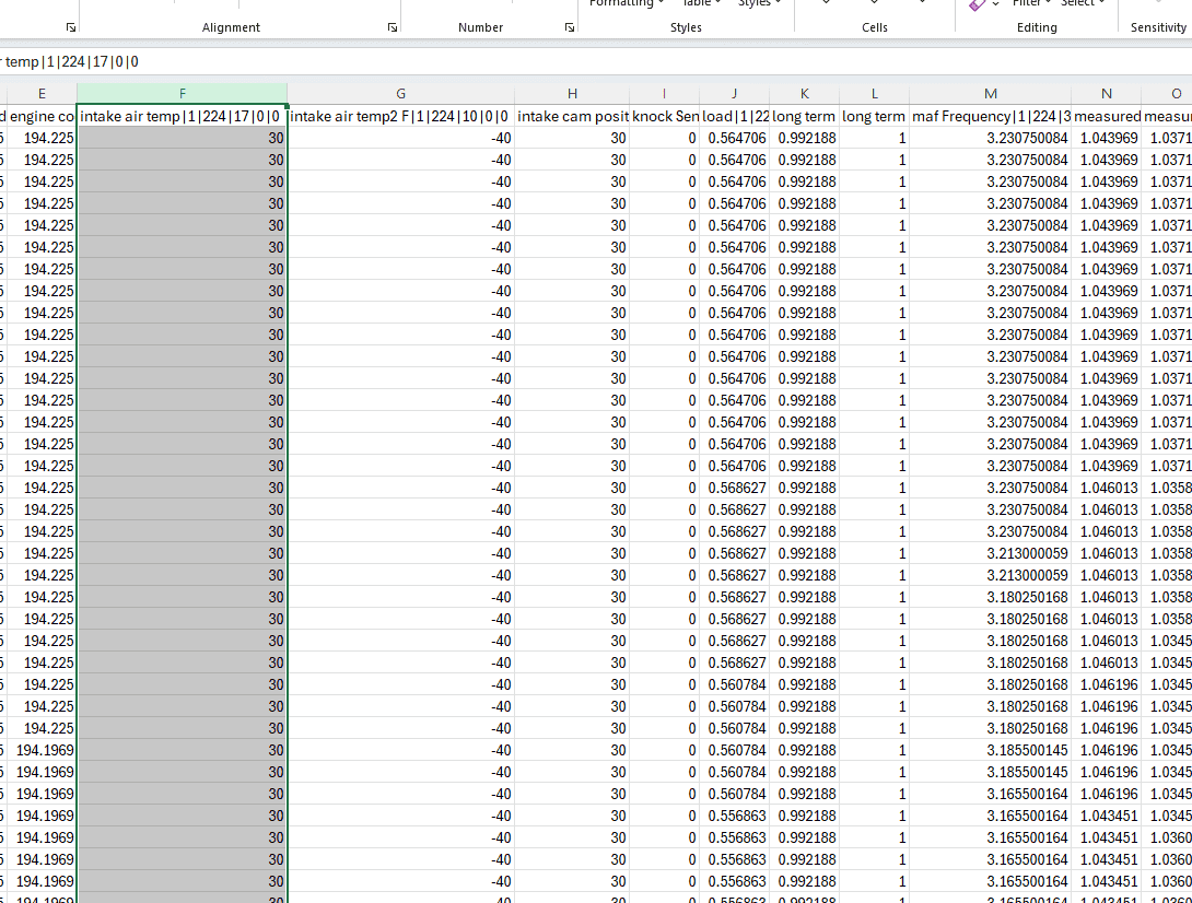

MAF is fine
What makes you think that?
Your IAT's are what I'd expect with an unplugged MAF. You logged maf frequency and it is not lining up with any period table I can find. Another sign it may not be plunged in or has broken wires. The sensor itself might be bad.
Anyway this is where the log says to look.

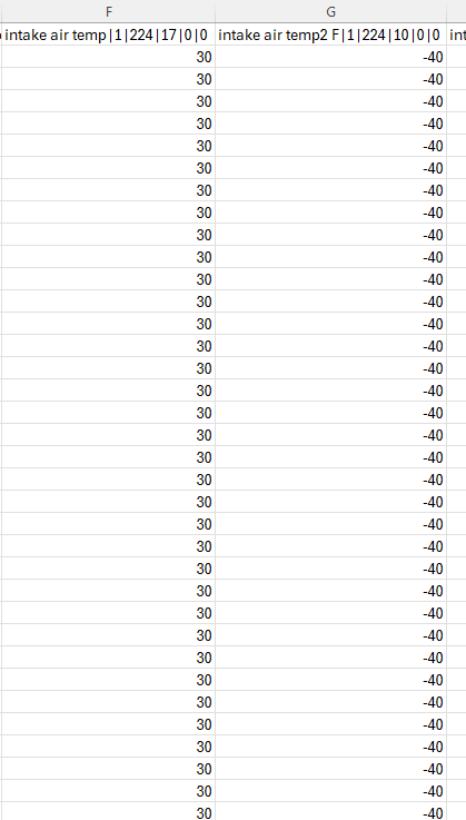

Also, your intake air temp seems odd,
Yes, it is stuck at -40 F. Either the op is in Antarctica or the temp sensor in the MAF sensor is not working.

Need to log MAF period to see if the MAF sensor is working.

well, was it 86 degrees F in CHarleston
Isn't the temp sensor in the MAF IAT1?
