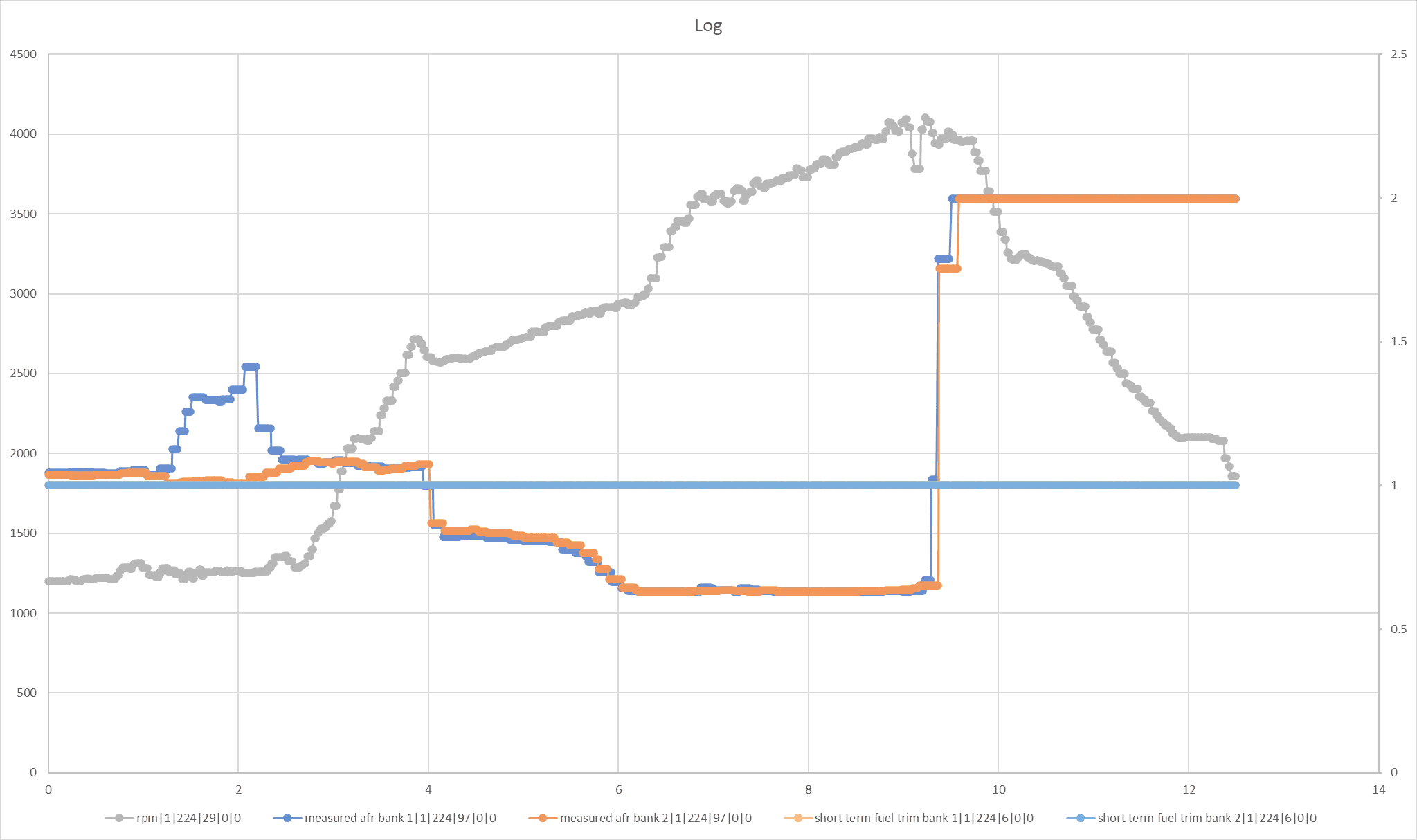

Been retuning my new 2021 GT, and my tuner says my data looks off. The only code I am consistently getting is P008A low pressure, but I'm still running rich on pulls, car is not adjusting like it should. I've got Stainless power headers and stainless work catback exhaust, and JLT CAI that were installed when I bought the car. I bought thru auction so previous owner was not disclosed. Injectors and spark plugs look to be stock, but I'm not sure how to check if other performance mods were installed. Attatched my latest datalog, a pull to 4k rpm. Any help is appreciated. Thanks!

Yeah thats really rich, 0.6 lambda at 4k RPM, 0.8 would be more normal.
That bank 1 AFR is odd at the beginning too, I don't immediately understand why it deviates from bank 2.
Your STFT is stuck at 1 the whole time, what's done to this car? Does it have a tune? I ask that specifically because it seems to be following a programmed curve during the pull, which leads me to believe that this is intentional and the previous owner may have tuned it to do this.

0.6 lambda is an afr of 8.5:1, which is rich for an NA coyote of any generation. 1 lambda is 14.1:1 which is normal. When you put your foot down it goes into enrichment mode and adds more fuel, and that typically ends up being around 0.8 lambda or 11.3:1 AFR. Before the pull, Bank 1 goes really lean for a second before hitting the target again. Which is odd. The STFT should not be 1 all the time, it should move around constantly, LTFT should move too but slightly slower.
The thing is that its following a curve, its not all over the place it looks like it was tuned to be rich like that.

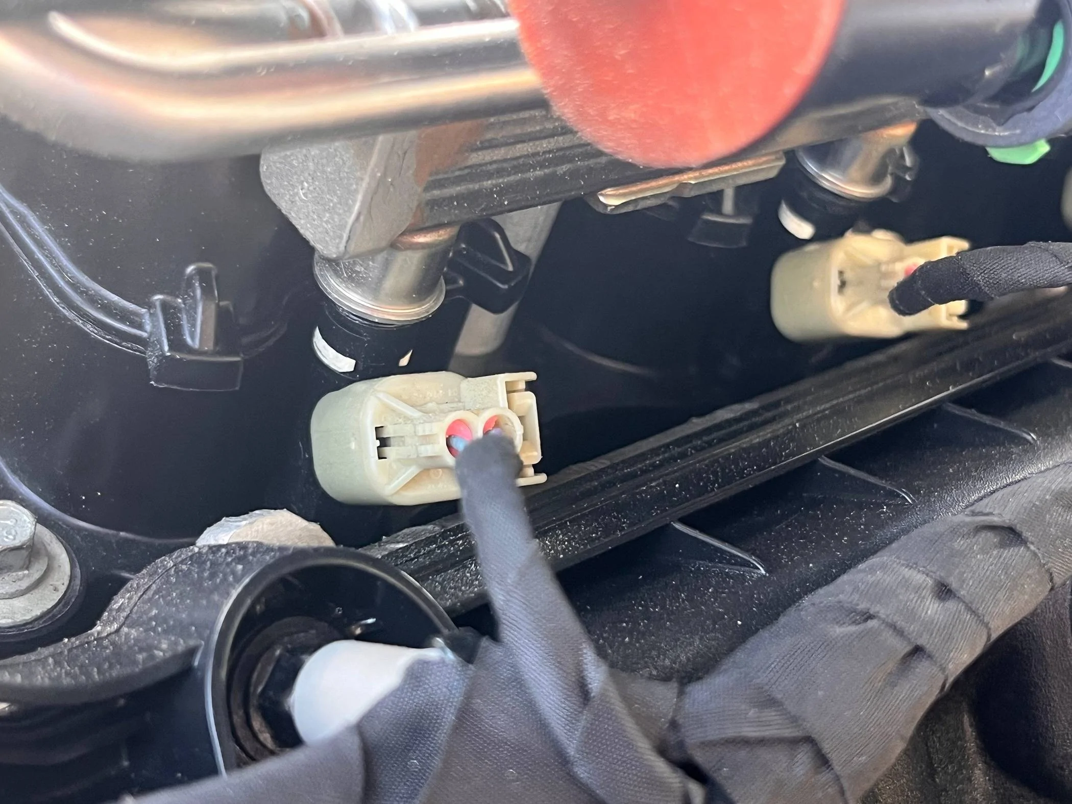

Guess other than the fuel pump, check the injectors 4-holes stock > 6-holes LU47's. But he should be able to tell in the logs.

yeah you have to get under it and look at stuff. Look at the front 02 sensors, the rear o2 sensors, the intake, the MAF, check for exhaust leaks at the block where the headers connect.

Quick glance, your throttle never opens past 40% and yout IAT is stuck at -40 F.
Make sure your wires to the MAF sensor are not cut.
