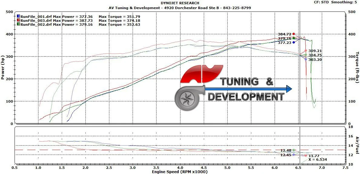

Grintch, power falls off pretty quick after peak power in the GT. Here is my dyno for reference

Also, an FYI for some who appear to be confused. The rev-limiter has no bearing on what an engine can physically rev to. It is only there as a safety net. Most manufacturers set them just after peak power is made...there isn't a whole lot of purpose to running a gear past peak power, unless you are too close to the next braking zone/finish line to upshift.
