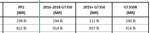

I believe these rates are correct :
Compared to what you have :

Here are the values comparing to the PP1 :
Note that I have found conflicting values for the PP1, hence the bold red text.
Also note that if you go too stiff without addressing the MR shocks / MR programming, you might not be doing yourself any favours ...

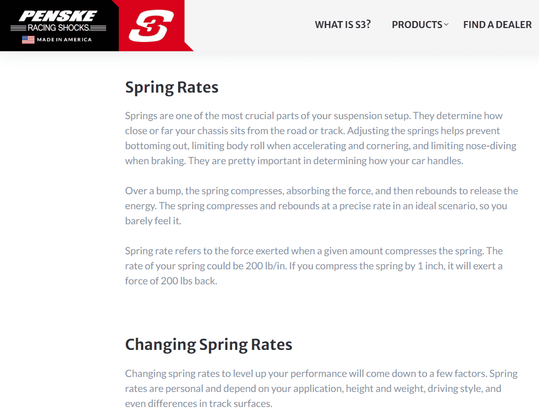

With regards to springs rates, it's very personal / application dependant (note the last paragraph) :

I'm by no means an expert at this ...
lbs to compress it 1" :like:
Note that its not directly comparable to your car weight though, as spring compression isn't always a 1 to 1 ratio to wheel motion due to suspension design / geometry. I've seen the Mustang ratio's mentioned on here before, but I didn't take note of them ... :facepalm:
In simplistic terms and for any given suspension geometry, a higher number is a stiffer spring.

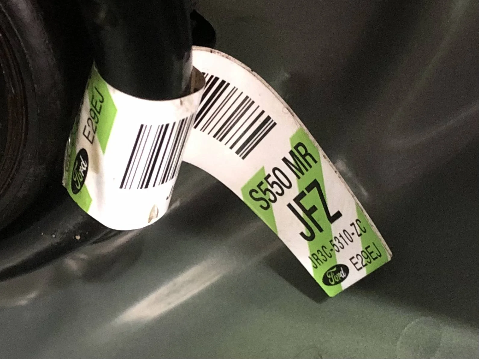

I just gather and hoard data for things that’s of interest to me - most (all ?) of it has come from various posts on this site. In the same file, I have all the alignment settings etc.
I can’t help you on the part numbers sorry, other than this I snapped of one of my fronts (U.K. / euro / PP1 / MR) :
