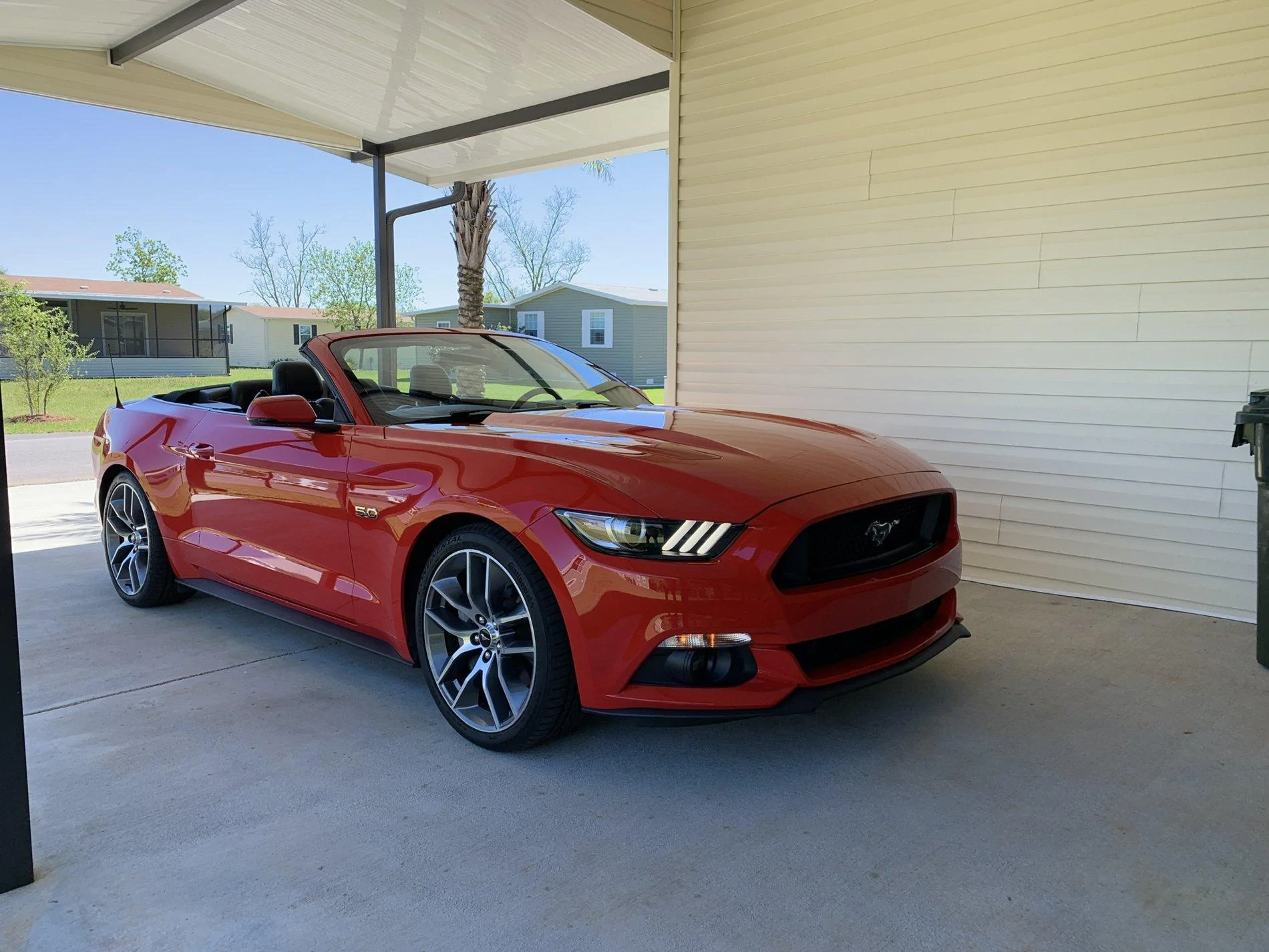

We recently purchased a CPO 2015 GT Premium vert with 31K. It had 87 in it when we test drove it I am pretty sure. I noticed it was not smooth in it’s low speed operation and would buck some. It was simply not smooth. I ran it down to almost empty and filled with BP 93. After about 50 miles it smoothed out. It also was more responsive at lower RPMs and throttle tip in was a lot smoother. It’s had nothing but 93 since and runs great. We just took a 1200 mile round trip and on I-10 I frequently had the cruise set at 80mph and got 24-25.5 using GasBuddy to track my mileage. I do not see me going back to 87. For me the extra cost is worth it.
