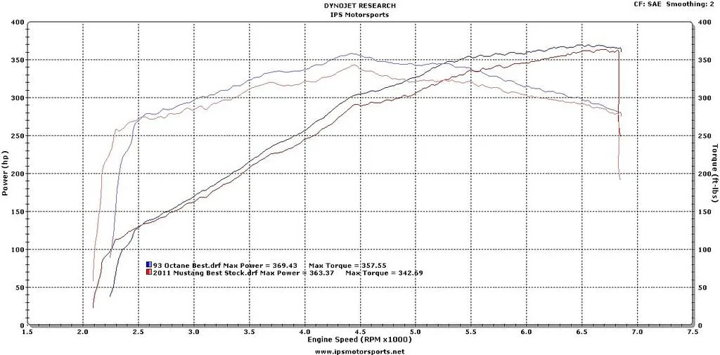

Disclaimer, Gen 1 Coyote. Below is a dyno graph showing the difference between 87 octane and 93 octane. According to the shop, no other changes were made to the car/tune/etc. Similar weather for both passes, carat normal operating temperatures.
Note: 6 RWHP peak difference. Not that much, but look at the difference in the mid range, especially 4500-6000 rpm. Looks to be ~20 RWHP difference in places (corresponding increase in torque, of course).
