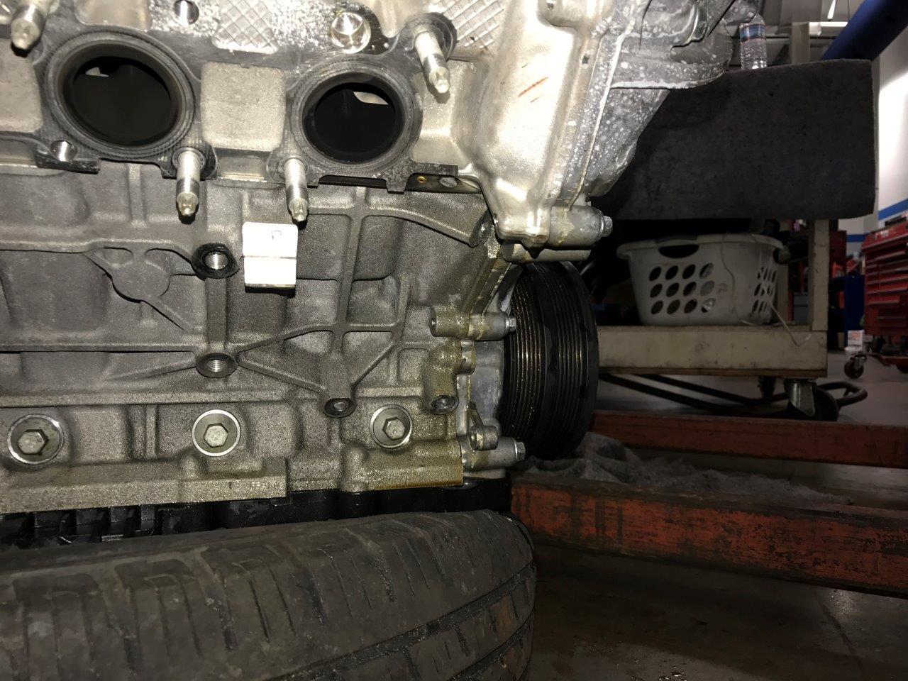

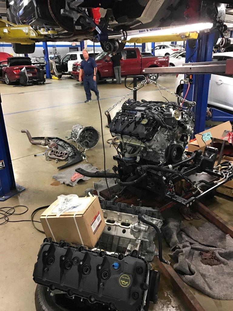

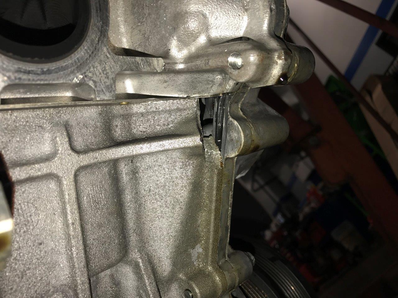

Update time. Engine is replaced and car is back in my care. I've attached the handful of photos I took of the existing engine. I haven't had time to take pictures of the engine bay but I will try once I get her cleaned up.
Here you can see the hole in my block where oil was leaking.
Here you can see where the two lower bolts that secure the A/C compressor are sheered off.
Just a picture of the whole thing, old and new.

Thanks for posting this update. I did not go back to read the whole thread. Did they offer up a theory as to the reason for the failure?

What a shoddy looking work area. Tires for engines...that's what I did as a kid. Splitters and misc parts laying on the ground on top of eachother? I'd be double checking the work done here.
