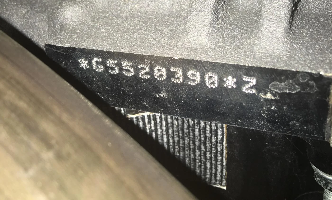

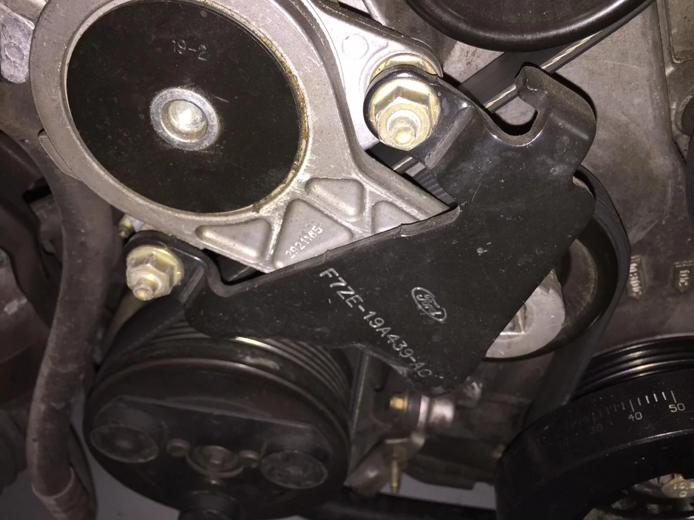

The casing of the block was "wrong" (I won't be able to get any good photos till it is put back on the lift). The connection point for the A/C compressor was cracked and leaking oil and also causing the belt to have friction. The dealership is trying to order a new engine but they said they are having trouble. They keep trying to place the order and the order keeps coming up with just a new block (implying they move everything else over). They don't want to do that (nor would I accept it that option). Any words of advice I could give the dealership so they can get this ball rolling? How long do you think is acceptable for a new engine such as this to be delivered to dealership? My fears is that this is a multi-month process due to the specialty nature of our engine. Speaking of engine change, are engines seralized to the VIN? Is this something they match when they do engine swaps? Should I be concerned about vehicle depreciation with a different engine? Thanks for the help.
The original engine is stamped with the vin number on the left rear corner of the block. Once they replace the engine it'll never be a numbers matching car again. Period.

As I said before. The vin number is on the left rear corner of the block. A replacement engine will not be a numbers matching engine anymore.

Carroll Shelbys Soul Lives Under My GT350 Hood
Block
