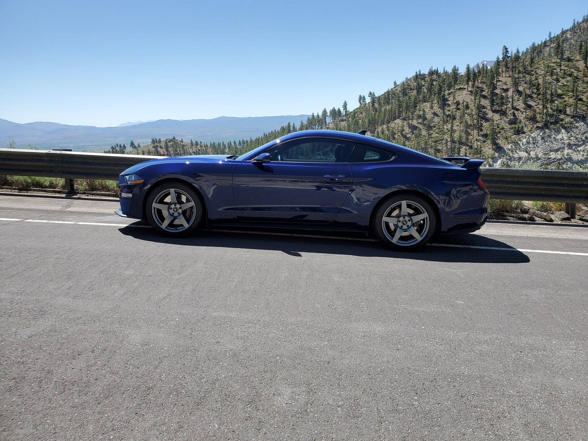

I just put on some 3mm spacers and picked up 2 spare rear wheels to run 9.5in on all 4 corners. Was an easy, cheap option.
When i need new rubber then I'll move up to probably 285 on all 4 coners.

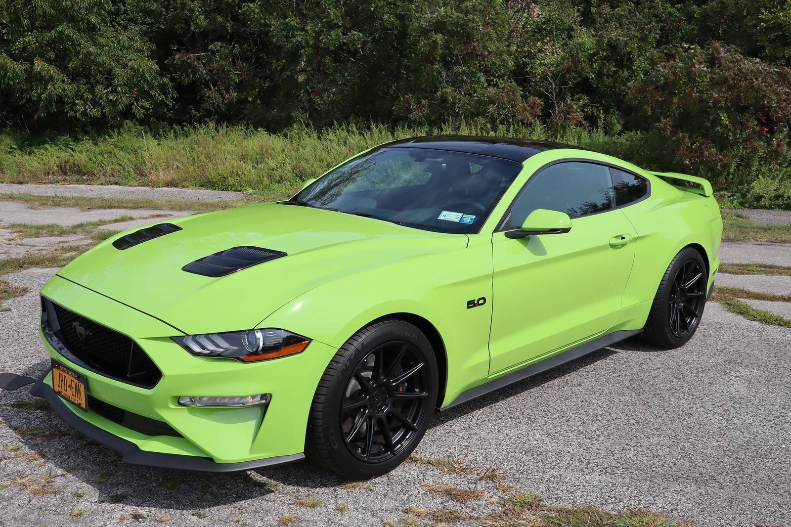

John
Current 275/40/19 , Niche Essen 19x10 et35, conti dws06, square. Magneride, PP1, stock springs.
