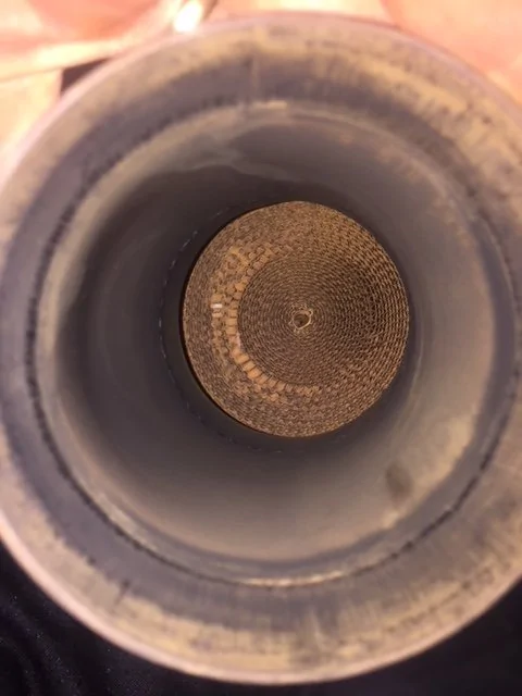

Still trying to figure out if it was tune that fucked up my driverside cat or it just failed on its own. Shop swears up and down it wasn't the Lund tune. The passenger side cat looks brand new. Why would one side fail? Just doesn't make sense to me. What do you guys think? Tune or it just failed on own?

Both my cats were fubar its not the tune its the cats themselves. Lund has tuned tons of boosted cars with cats..American racing headers will tell you that their cats cant withstand extended periods with boost. Remember The arh exhaust system has a lifetime warranty on their products they’ll keep replacing them as they fail..but they wont cover a broken motor from it.

Kooks headers with green cats about 3 years old 10k miles. One of the cats here as you can see is separating and folding in a bit. Anyone have experience with this with Green cats? I called Kooks today and the warranty is 2 years, but they may warranty anyway when they look at the pics.
