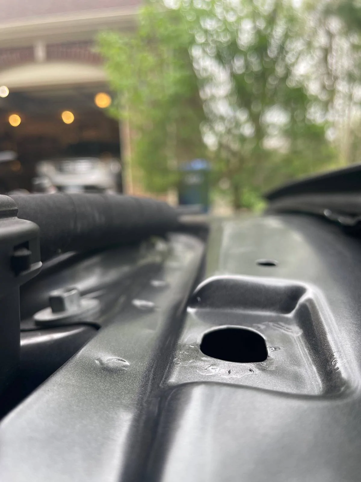

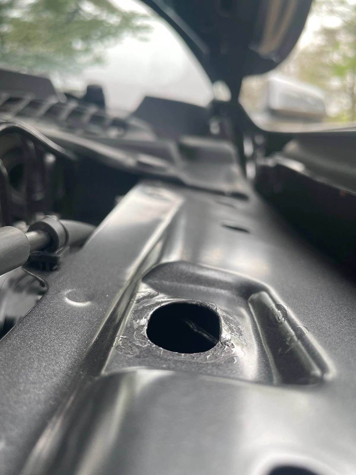

I went ahead about a week ago on a rainy day and installed the FP Hood Strut Kit. I hadn’t seen the negative reviews of them prior to installing, but I have now. My advice is steer clear of these hood struts, they’ve caused light to more severe damage to several peoples cars from the nature of the bottom bracket. I actually am one of the lucky ones because it hardly did anything to my car before I realized and removed the kit. Touched up the paint in the meantime, but going to have a local resto shop flatten out the holes and respray the area.

agreed. Torquing to spec will not hold them, and too much torque will distort them. Absolute junk. I also quadruple checked I routed the wash hose the correct way per instructions and they still broke the hose.

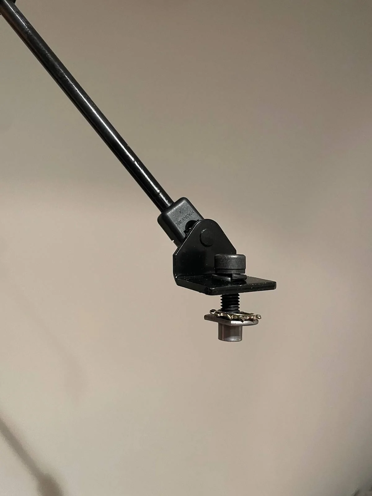

The FP strut brackets are total garbage. I purchased a set, and knew about all the issues (as I always read after I purchase 😒) and was able to dick around with them enough to get them successfully installed without damage. Never mind the crap bottom brackets, the top brackets are no better. The hood flex is absurd. Hindsight? Redline or similar. If anyone is considering the FP set, just look and compare the HOOD brackets between the two sets; it will be painfully obvious as to the superiority of the redline style 👍🏻

Bought FP struts, caused same or worse damage as the OP, sent them back (amazon prime), ordered roush struts and what a difference. Roush ones are awesome. Take a look at the cjpony install videos and you'll see how much superior they are at mounting points.
FP struts are total twisting and bending garbage

I would just hammer it flat and use larger washers (than the supplied ones) to spread out the load.
