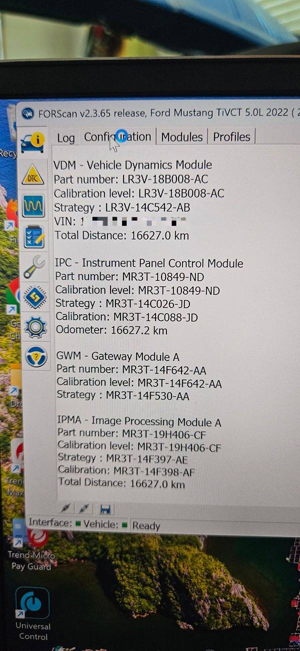

I just checked 3 different Mach1s in both hpt and pcmtech and all 3 have it turned off. Let me know your OSID or Strategy and I can look up yours.

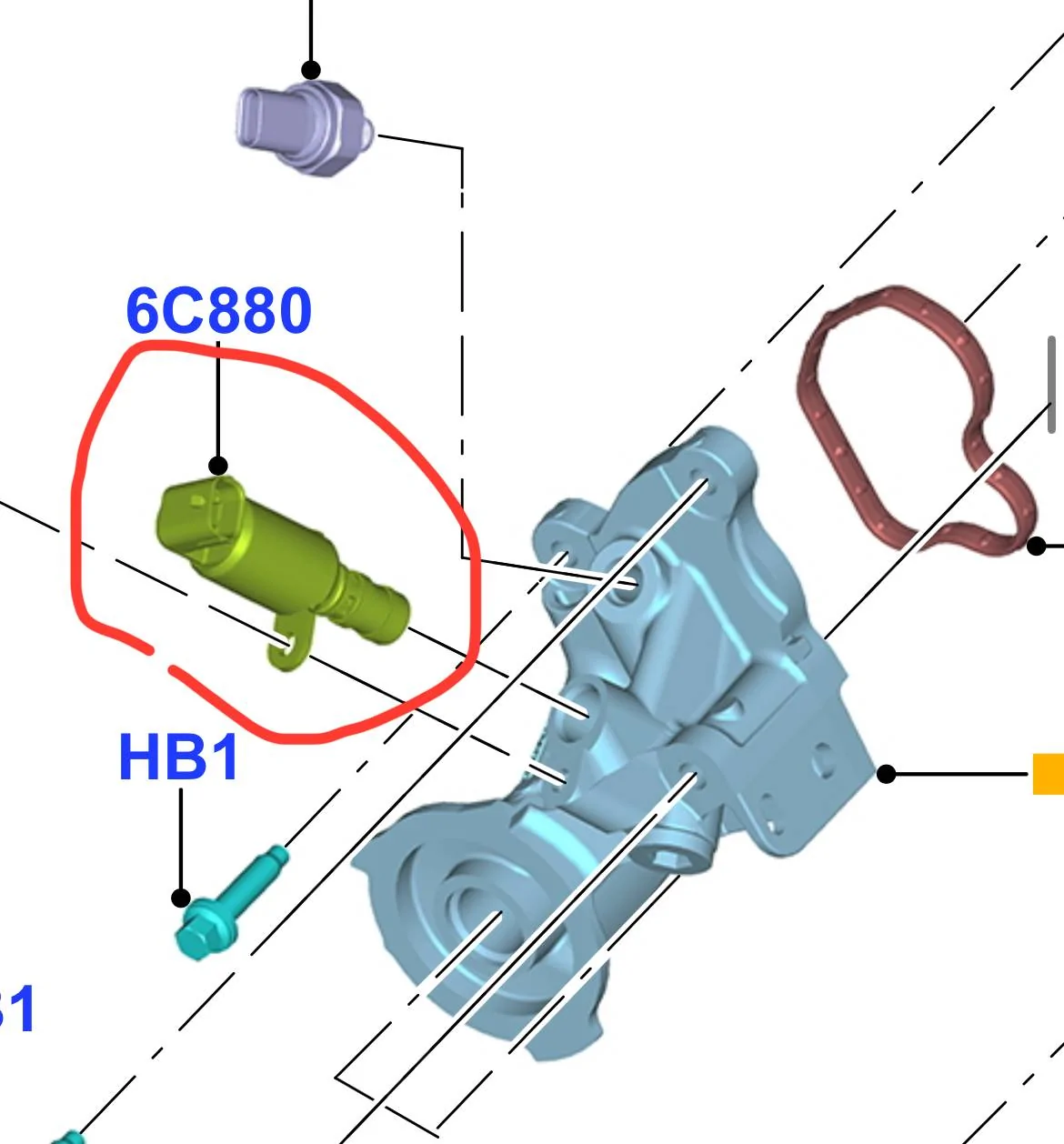

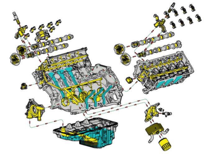

A good friend of mine works for Ford and was kind enough to get me a few diagrams. At least for the 2022 model year, the GT does still have the oil pressure control solenoid:

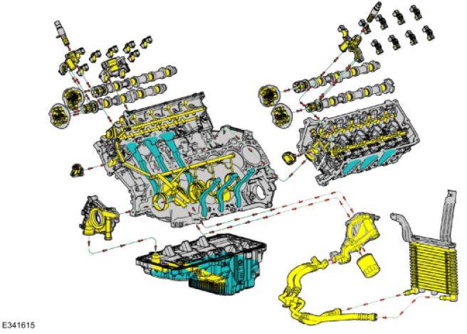

The Mach 1 does not:
Since the switch to 5W-50, my hot idle oil pressure is much better. Even with restrictors in the turbo oil supply lines, there was evidentially just enough additional flow demand on the pump at idle RPM to drive the pressure so low. Even a few hundred RPM made it rise rapidly, which is why I thought it had the variable system. The additional lines and cooler plumbing are probably why the solenoid wasn't included to begin with
