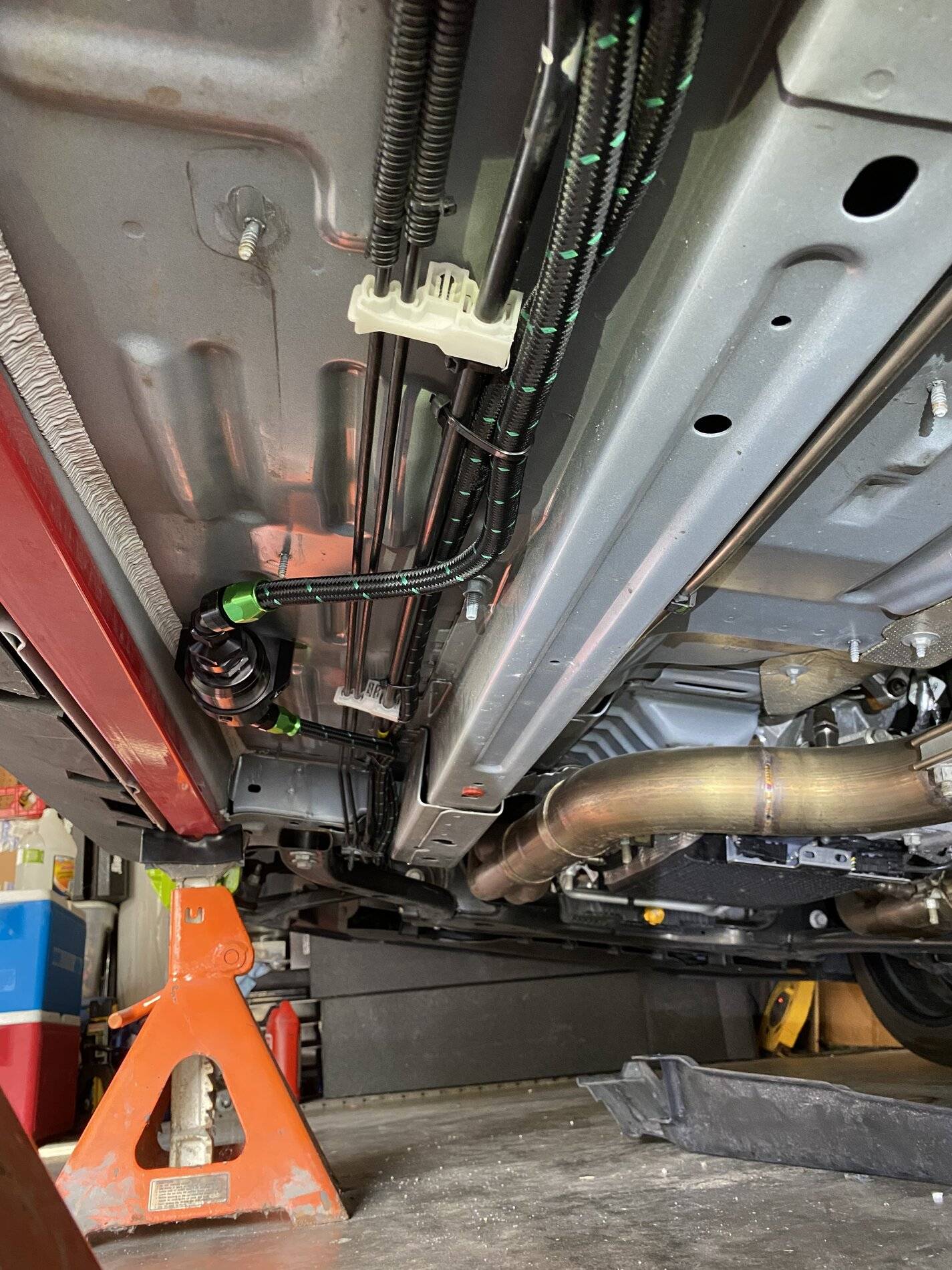

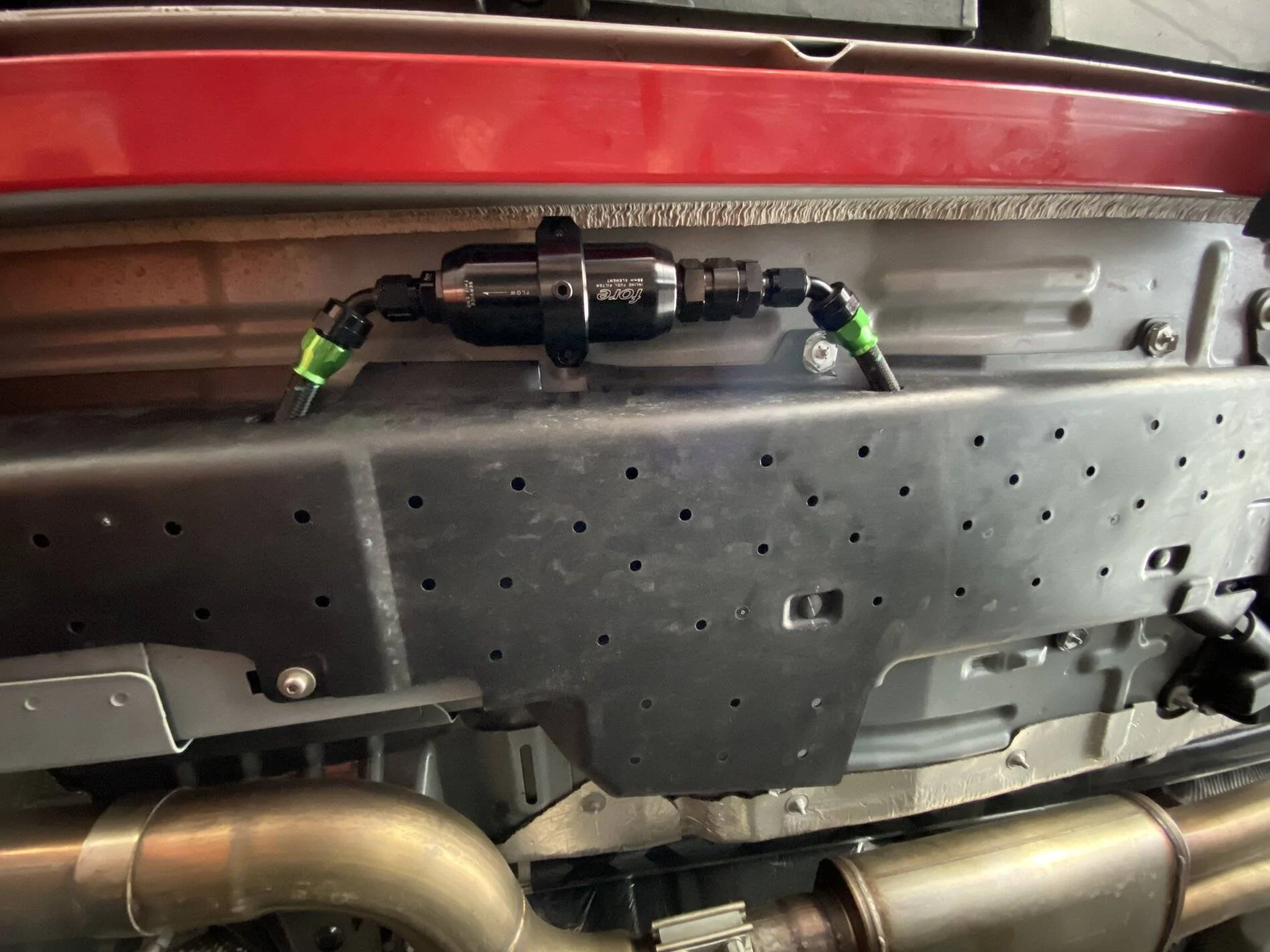

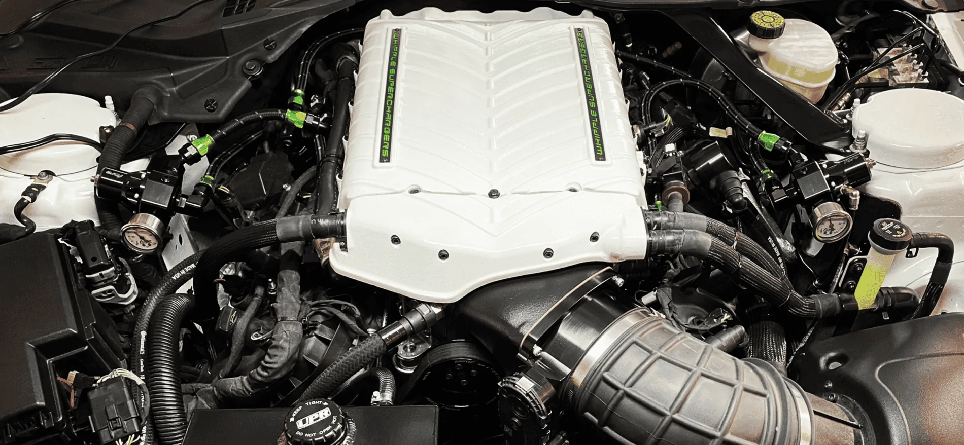

I just did the Fore L2 with twin 525lph pumps and ID1050x. I used all ptfe line and fittings from hotrodfuelhose.com. Very happy with it and totally rips on E85. And better on 93 as I was maxed to begin with. I made brackets to mount the regulators cause I wanted em to be mounted the same on both sides.
