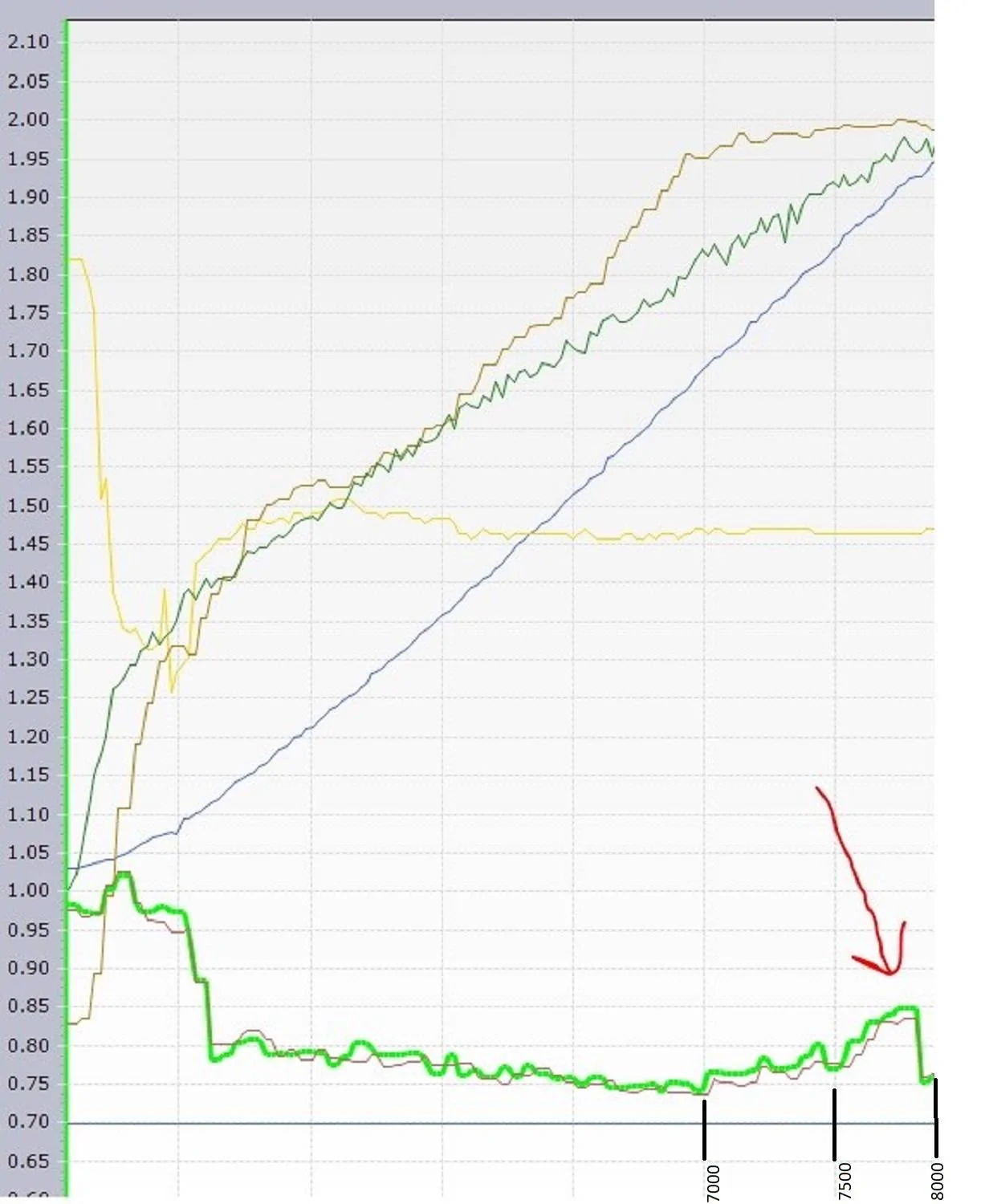

I wonder if it was a voltage problem, likely a spike when the hobbs triggered a relay and the relay maybe having a bad contact/intermittent contact?
Not sure it was even coming on. Running twin 465's... think I was maxing out one pump and not triggering the second one.
