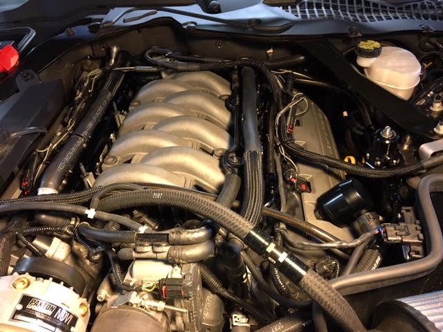

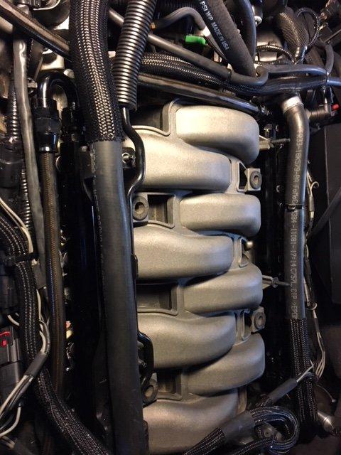

I would set it up with rails in parallel if you have the parts. The car will have more potential and start better when hot. I built my own system around a fore hat. 10 AN feed to Y block, 8 an from y to each rail then ran outlet of each rail to the regulator. It is easier to do it right upfront.

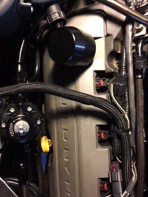

for the love of god, please tell me where you got the AOS that connects to your pcv like that. IDK who builds these.
