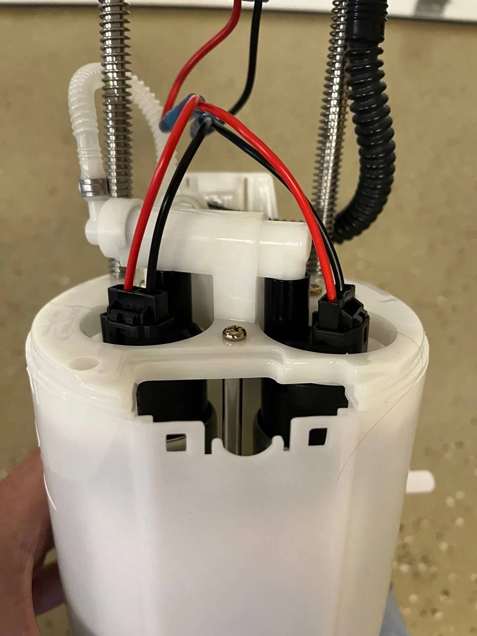

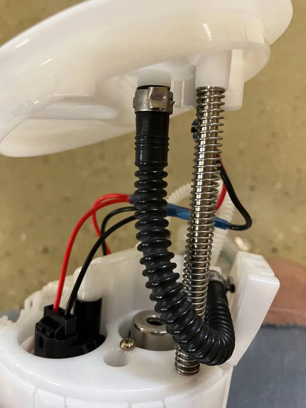

This is not an every track problem. But at Barber Motorsports Park after coming off the museum turn, turn 9 the track then bends left into a moderately fast left-hand sweeper. Last time I was at Barber in 2023, I would consistently have engine cut-out going into this corner if the tank level was 1/2 or less. Hugely annoying as its not good for the motor as it will go lean and basically it means you have to tank up after EVERY session.
I had known thqt KPM was working on a solution (I didn't care about their 1,000+ HP capacity pumps) and that their fix had a dedicated pump working the saddle tank to keep the fuel canister full in all conditions. Installed this last Fall but didn't get to test it until this past weekend. Can confirm it's a 100% fix. It's not inexpensive, but it does work. Ran tank to just below 1/4 and it never stuttered or hesitated at the corner once.

Pump has been great. Complete fix to the problem. Required no tune, no adjustment to fuel pressure or anything else. I ordered the 1000HP pump as that was the smallest one at the time. I understand there's an 800HP pump available now which was not available when I ordered mine.
It's a complete fix to the problem, I have run my tank, on track to well below 1/4 tank with absolutely no issues. Did not intend to run it that low as I started well above 1/2 tank but the car is certainly capable of burning some gas when pushed.
Only advice, as this is a simple DYI project. When you go to change the pump; 1) buy a fuel pump "opener" tool (well worth it as it's really tight); 2) Run the gas tank down as low as you dare to without running out of fuel. Much less messy and less gas to deal with with doing the exchange.
