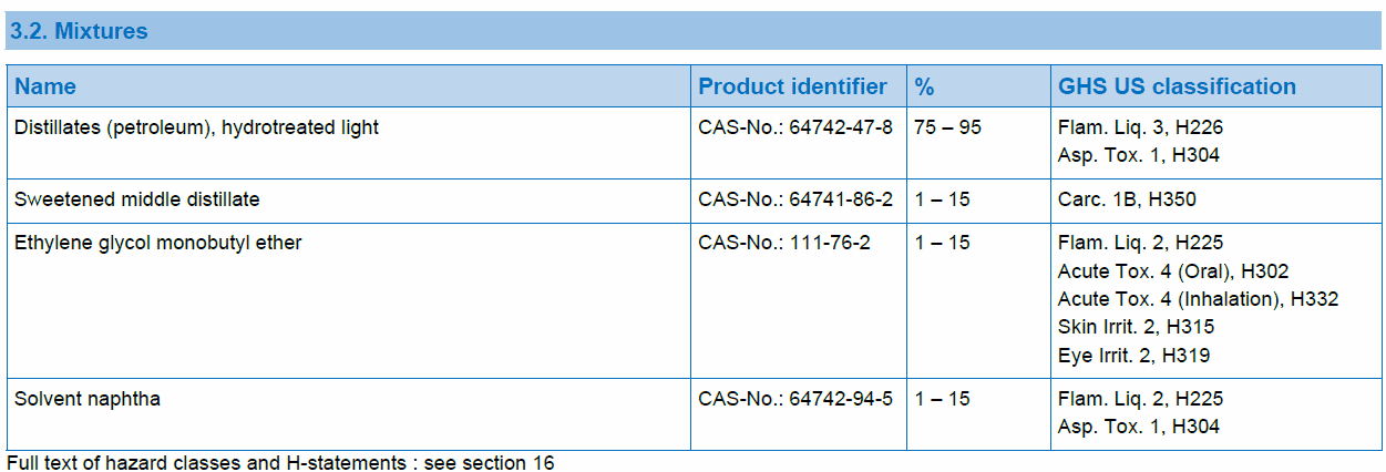

I tracked down the SDS (Safety Data Sheet) for Sta-bil and here's what it says is in it:
From this list, which shows no inorganic chemicals (and the rest of the document doesn't indicate any inorganics either) it looks like the ethylene glycol monobutyl ether (EGBE)is the "active ingredient" and everything else is either a carrier or a solvent.

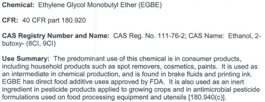

Here's what the EPA says about EGBE:
Now, EGBE is used in brake fluid, and one thing we all know about brake fluid is that happily absorbs water. Presumably, in Sta-bil, EGBE's job is to capture moisture in the fuel and keep it in suspension, as opposed to letting the water form a puddle at the bottom of the tank - the kind of puddle that's famous for cutting engine power on take-off.
Now, I'm not offering professional advice here, but from taking a look at the molecular structure, which is way simpler than the name, it should burn cleanly and easily without leaving any residue. And any water is just water, so it turns to steam on the way through the engine.
