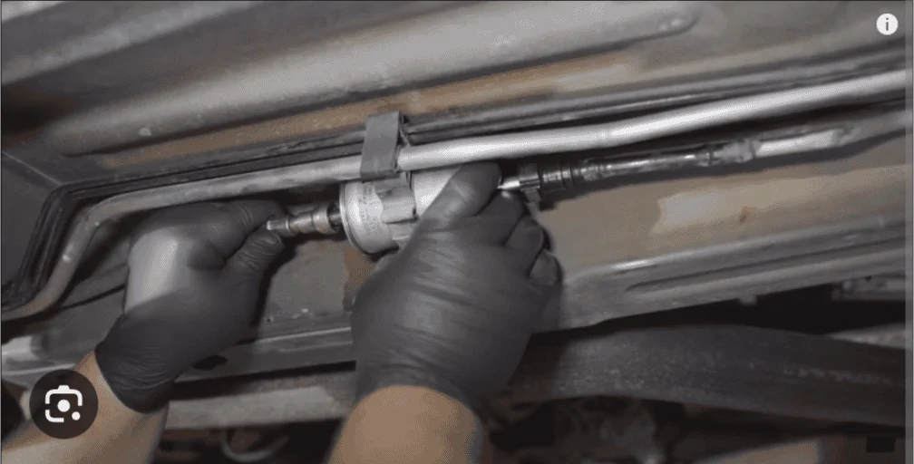

Thanks guys, not sure if this is what your referencing, but Ill put a pic in here. It's not necessarily in the tank or pump

I don't believe any s550 comes from Ford with an inline fuel filter like what is pictured here.

I'll have to double check my car. I have been doing some routine maintenance lately so I came across this filter on American Muscle and figured why not since it's a filter lol But they sell them for s550, not sure if it comes standard with one or it's some additional mod to the fuel system/lines

I can assure you it doesn't have an inline fuel filter. GT350 does but that's not even a GT350 in the picture.

Can’t comment on the pic, but the 350 does have that style in line, replaceable filter.
