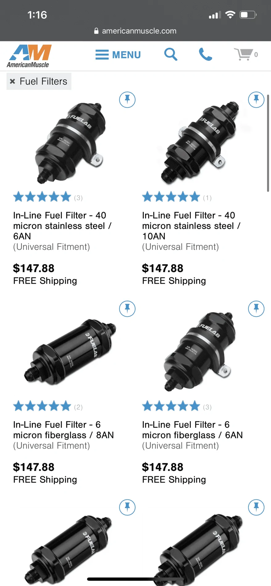

I’ve just hit the 50k mark on my car, and I’m upgrading some misc things, one being the fuel filter. I was wondering if I should go with one of the universal ones from americanmuscle? Or just go to Ford and say I need a replacement OEM filter.
What benefits would I see from going with one from americanmuscle if any? And what do the different sizes mean in this picture?

There's no fuel filter on any S550 Mustang. If I am remembering correctly, the last model year of the Mustang that had a fuel filter was 2010.

The micron number is the filter rating. The XXAN number is the fitting size. Those filters are usually added on a return type fuel system. A return type system is something you usually do going boosted and high fueling requirements. The filter on an S550 is located in the pump and is not serviceable

This is correct.
