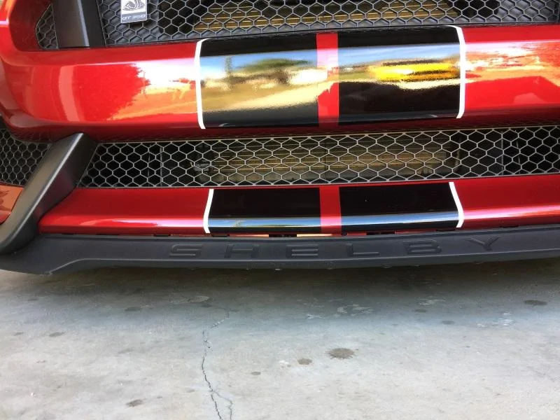

Yeah. That's why mine is installed wrong right now. I'm going to have to take it off and reinstall it correctly, but want to have a spare on hand before doing so. It's scraping like crazy and I don't think it would scrape nearly as badly if it were installed properly.
Note: Just to be sure, this is installed incorrectly, right?
machsmith
Mar 5, 2016
3,610
2,043
somewhere along the river
Jim
Honda Minis
Yes, you shouldn't have any gaps in there
Thats a terrible job!
