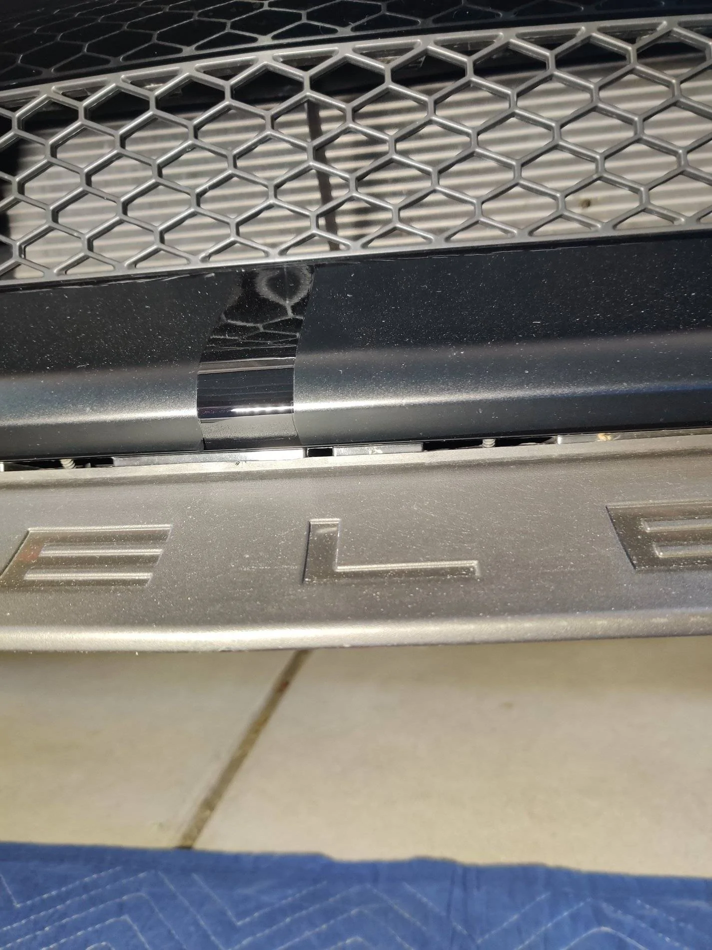

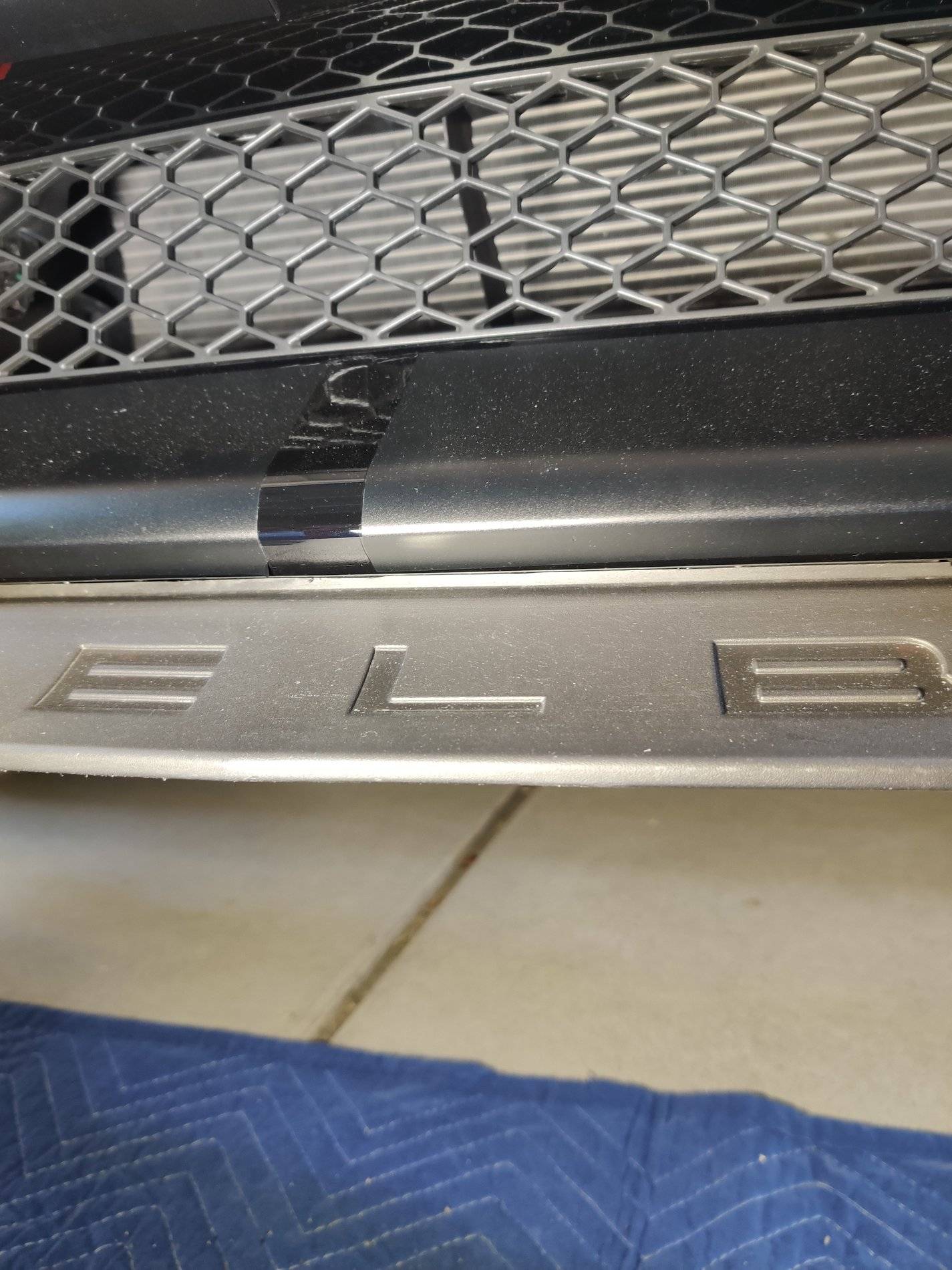

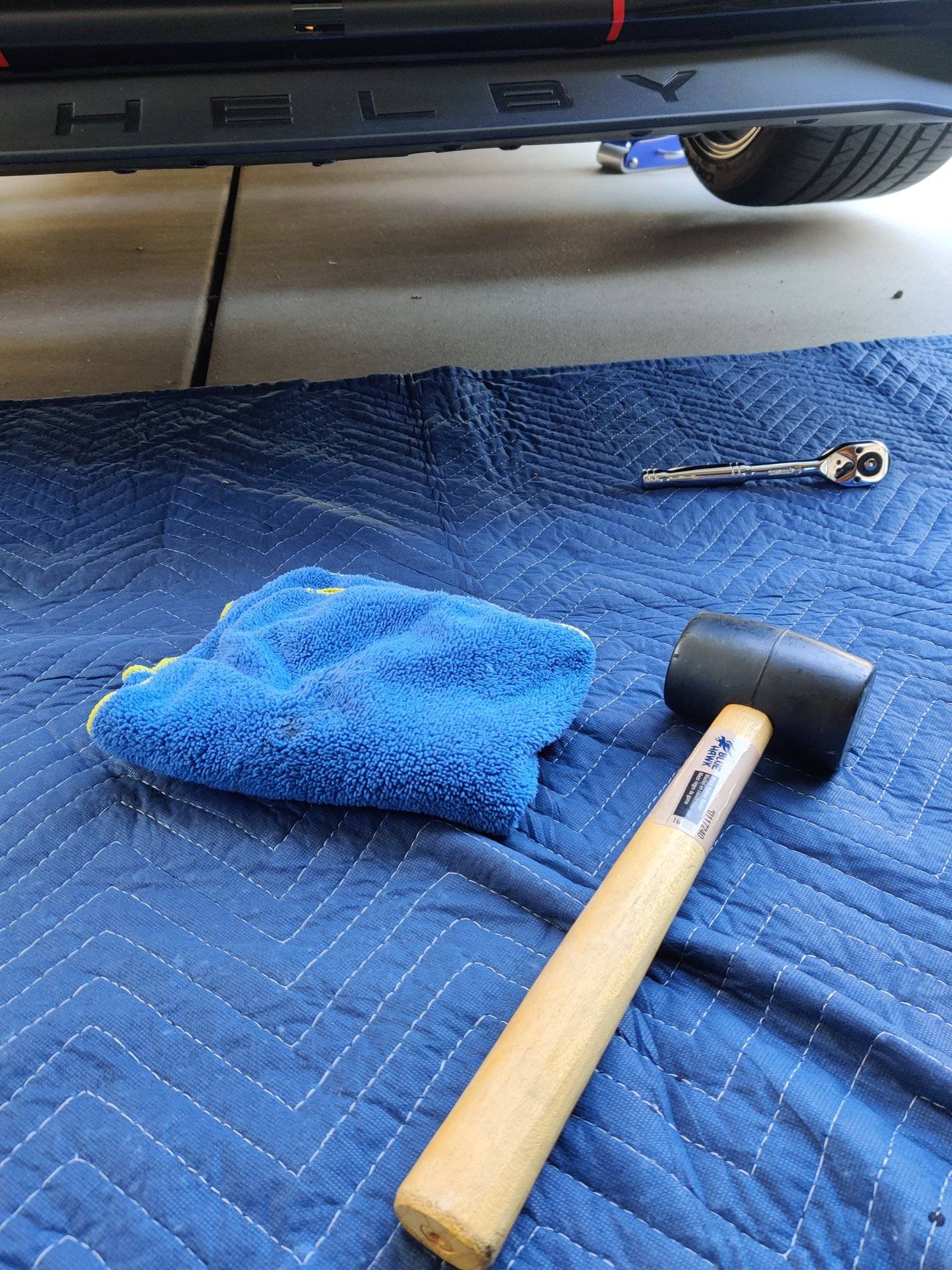

I had the same thing. Rubber mallet hammer and towel fixed it.

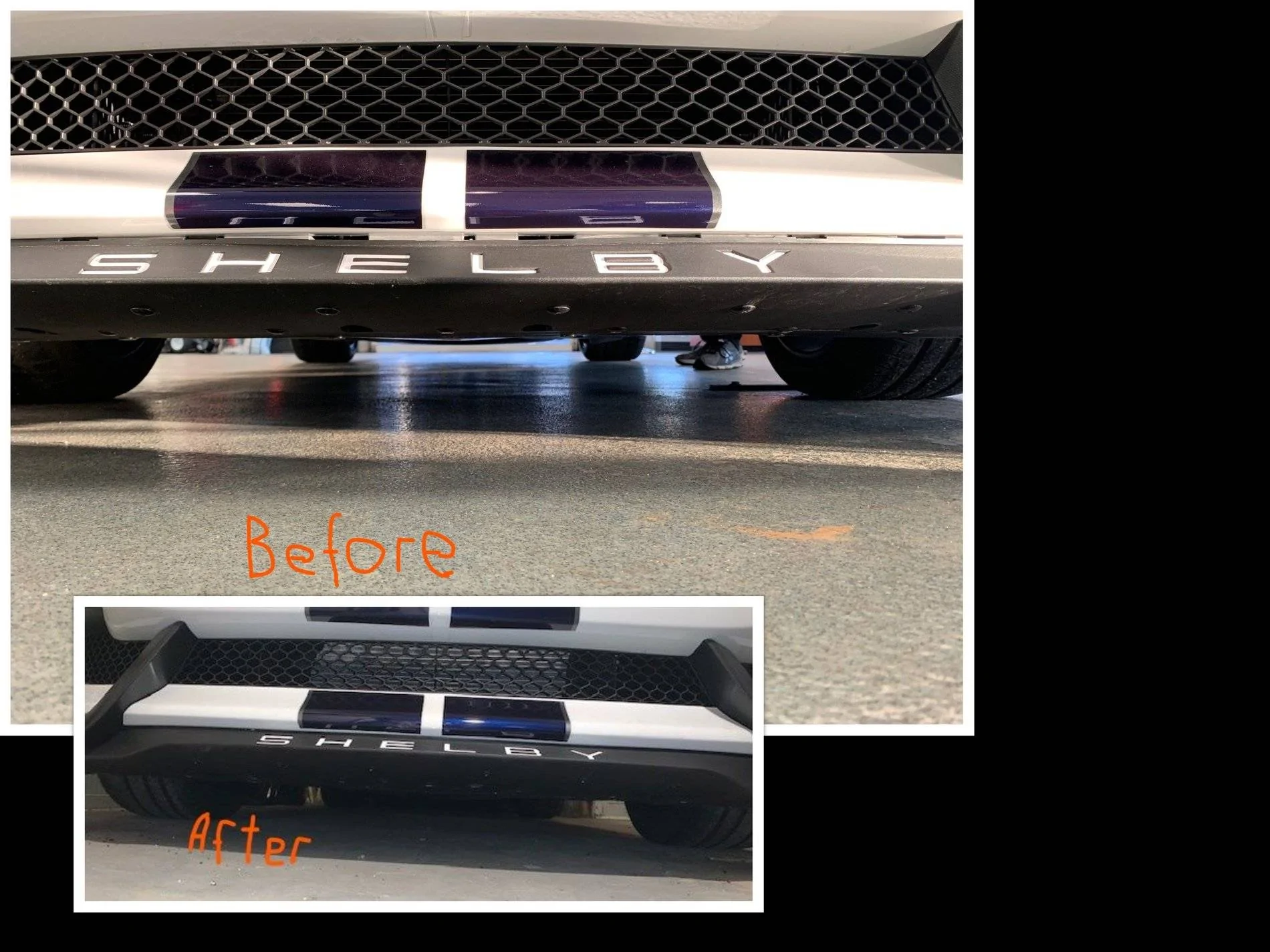

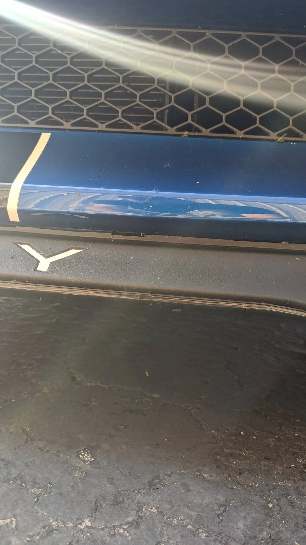

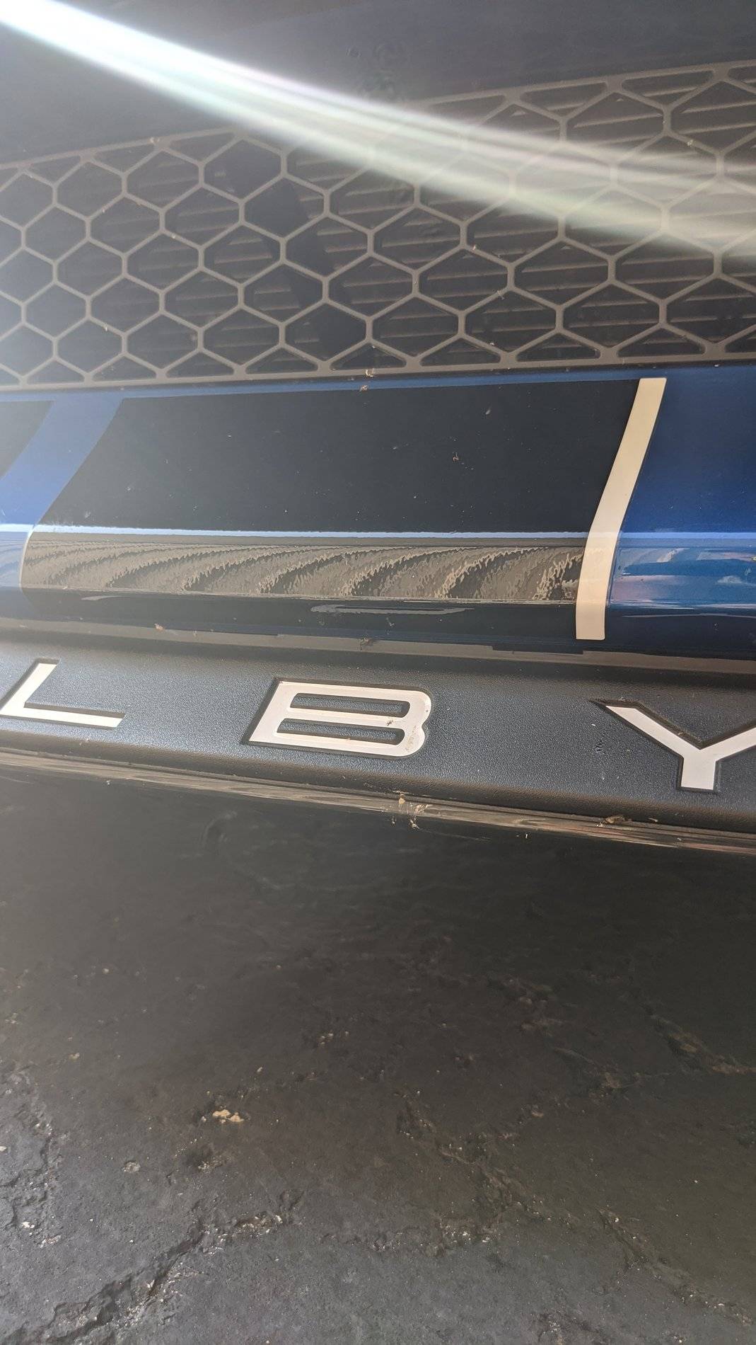

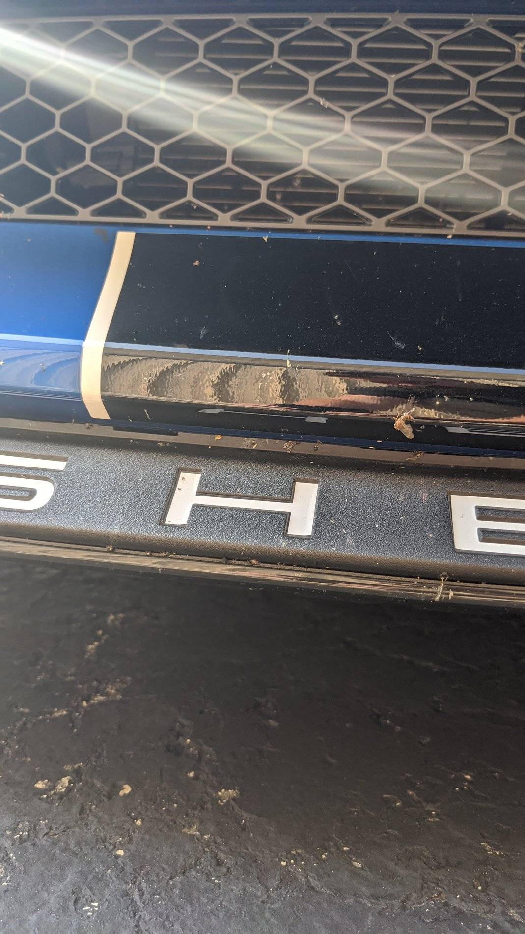

Thanks guys for the replies and pictures.. it definitely looks like it can go in further. I don't have a jack or jack stands... wondering if I can still accomplish this while it's at normal height? Your placing the towel and striking the splitter on the front edge, correct? or are you hitting it from the underside of the splitter?

Would second your instinct to take it in to a reliable dealership to double check and make sure it's seated properly. Often when they are not seated correctly they also didn't use all the clips and screws because they didn't watch the installation video to get it correct in the first place.

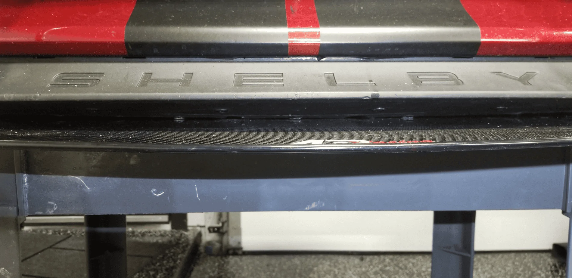

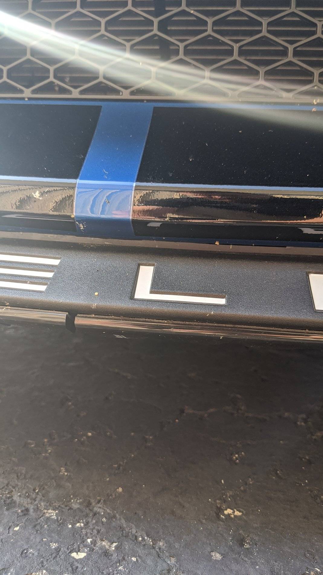

This is mine. Sorry for the dirty just got back from track day. Yours looks good Lorne
Thanks Andy, it seems weird that those clips are exposed like that, but this whole splitter install and stabilization business seems a bit cloudy. I will be taking my 350 into the dealership soon anyway to get some new wheels mounted, so I will have them just take a look and make sure all the hardware is there and that it is secure....

Here's mine before I changed the setup around and I promise this was on the all the way. Those slots are normal. If the *tallest* part of the splitter is touching the bottom of the bumper, it's locked in.
thanks Kevin, I appreciate it! I will still confirm with dealership that all the hardware is attached....I bought it used,so wasn't there when dealership first installed it. I'm going in anyway for other work. But this is very helpful...
